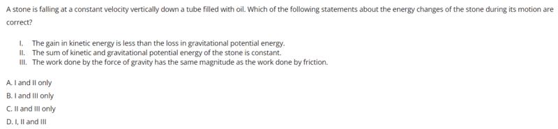

A stone is falling at a constant velocity down a tube filled with oil. Which of the following statements about the energy changes of the stone during its motion are correct?
I. The gain in kinetic energy is less than the loss in gravitational potential energy.
II. The sum of kinetic and gravitational potential energy of the stone is constant.
III. The work done by the force of gravity has the same magnitude as the work done by Friction.
PE = mgh
KE = 1/2mv^2
This question does not have numbers, so I'm stumped. Here's my thinking.
  • (I), the gain in KE is less than the loss in GPE is correct according to the key, but I think I don't understand this conceptually. Can you ask me questions to make me think about this a bit more? I can't even form questions to ask myself. I don't get this one at all.
  • (II), According to the key, this is wrong the sum of KE and GPE is not constant. But why is that? Isn't there a formula that goes, ME = KE + PE. If that's true, then when KE changes, PE will also change, but they will still both add up to ME. Then shouldn't be ME constant?
  • (III), the work done by the force of gravity has the same magnitude as the work done by friction. This is correct because they're opposing forces in this case and they'll be equal in magnitude but in opposite directions.
Here's a picture of the question:
Thank you!
What is the gain in kinetic energy when a mass is moving at constant velocity? As the mass falls, does it gain or lose potential energy? Start from there.

Oh. I misunderstood the question. Okay, if its velocity is constant, that means that KE will always be the same. As the mass falls, the potential energy will decrease because of h decreasing.

Yes, it is possible for the stone to fall at constant velocity just like a parachute. Air is a viscous fluid except that its viscosity is lower than oil. A mass falling through a viscous fluid will eventually reach terminal velocity. Read about drag here. When terminal velocity is reached, the drag force (which is velocity-dependent) is equal to the force of gravity and the net force on the mass is zero. This means that, after that point, the mass will keep on moving at terminal velocity until another force stops it.
