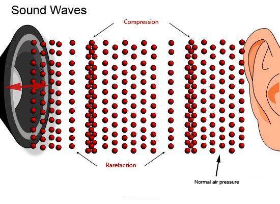

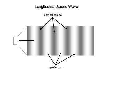

Lammey said:
I want to understand the mechanism by which the waves on the string cause the waves in the air.
it's the same process as with a loudspeaker ...
as the speaker cone ( guitar etc string) moves back and forwards, it compresses and rarefies the air that is in contact with it
the frequency produced is determined by how many times it does this per second. A wavelength ( one cycle) can be measured by the distance
between 2 consecutive compressions
here is a video that may help you as well ...
Dave
View attachment 94473 View attachment 94474as the speaker cone ( guitar etc string) moves back and forwards, it compresses and rarefies the air that is in contact with it
Dave
