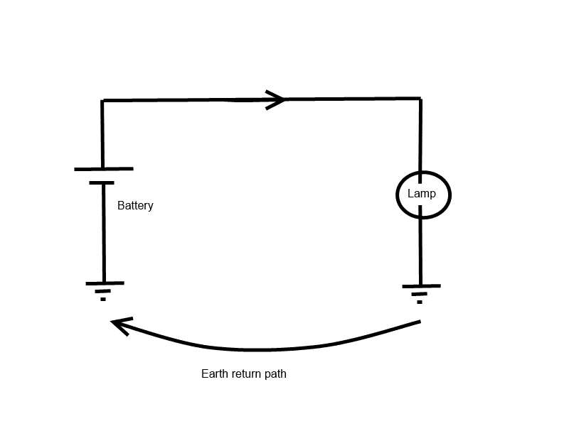

First of all , I'm a completely new to this current - voltage concept , I have problems understanding Grounding and the current flow in circuits . 1) Which path do currents take when there are multiple grounds in a circuit .
2) How and where should a circuit be grounded and why ?
3) Why is Earth considered as an Infinite source /sink ?
4 ) If we use a "'metal plate "" in a circuit ( Would it get charged after the electrons flow to it from the battery ( Please bear with me , it might be a stupid question ))

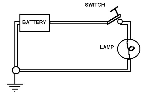

4) If a circuit( consider a basic circuit , where there is a battery and a bulb ) When the grounding is done to this circuit ,Why won't the electrons from the Battery flow to the Ground ? Since Ground is considered as an infinite source/sink .
5) I have trouble understanding How battery eliminator works ( comparing it to chemical cells) .
Thank you ! and Please help me .
They do, but through the bulb, if the bulb is glowing. All the currents in the circuit flow to the ground. Ground is a single reference node in the circuit. In many single-source circuits, it is assumed at the negative terminal of the source.
Assuming you have a circuit similar to the one below, the simple answer is that they charges don't have the choice of flowing to ground. The potential difference across the terminals forces charges off of one terminal and into the other. The number of charges leaving the negative terminal must equal the number of charges entering the positive terminal, otherwise a charge imbalance develops inside the battery and the resultant electric field prevents charges from leaving the negative terminal in the first place, stopping the flow of current. If charges moved from the negative terminal to ground in the following circuit then just such a charge imbalance would develop.
For a current to flow you need a closed circuit and a voltage. With only one connection to Earth that part of the circuit isn't closed so current doesn't flow in it. You can get current to flow to (and from) Earth like this.
