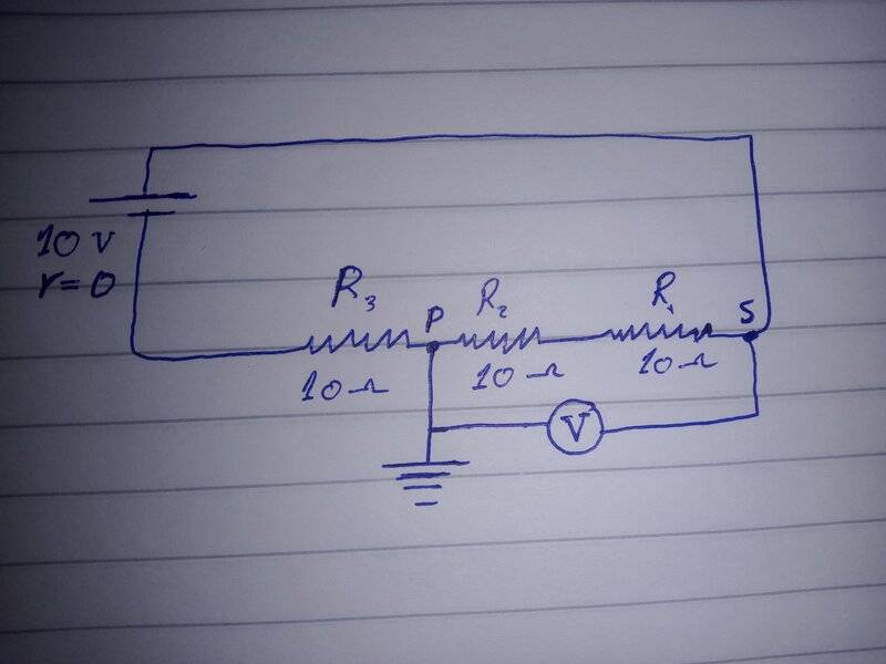

An electrical circuit with three resistors and a battery connected in series. After the first two resistors, there is a point connected to the ground. Why is the voltage difference between the ground point and the positive of the battery not 10 volts?
In electrical circuit there are three resistors and a battery connected in series. After the first two resistors, there is a point connected to the ground. Why is the voltage difference between the ground point and the positive of the battery not 10 volts?
In that circuit, I think that the voltage of point B is 0 volts because it is touching the ground, and also the voltage of point S is 10 volts because it is connected directly to the battery, but why is the voltmeter reading not equal to 10 volts What is the difference between the voltage of points S and B?

Given the exact drawing you have presented, the 10v reading does not make any sense, BUT ... without context, it is impossible to say that the drawing does or does not represent the "normal" assumption that the negative side of a power source is connected to ground.
If it is indeed a battery, then no connection to ground should be assumed and, as I said, the 10v reading would make no sense since the connection to ground is not part of any complete circuit and therefore has no current flowing through it.

The ground symbol in schematics is an arbitrary name for a circuit node. If there is only one drawn then it is meaningless.

The battery will cause current to flow through the resistors. Each resistor will have a voltage drop across it according to Ohm's law. Kirchhoff's voltage law says that the voltages around any loop must sum to zero. Your voltmeter isn't measuring just the battery voltage, it's measuring the battery voltage minus the voltage across R3, which, by KVL, is also equal to the sum of the voltages across R1 and R2. This circuit is often called a "voltage divider", if you want to search for more info.
So,
step 1 : What is the current flowing around that circuit loop?
step 2 : What is the voltage across each of the resistors due to that current flow?
There are some excellent tutorial videos at Khan Academy, check those out.

The ground point is irrelevent - have it there, remove it, the voltage isnt going to change
why isnt it 10V .... because the voltmeter ISNT directly across the battery -
and that is the ONLY place you will measure 10V difference
I assume you meant point "P" not "B" as there is no "B"
again, irrelevent as nothing else anywhere else in the circuit is commected to ground
No, as the other side of the meter ISNT connected to the other side of the battery
again, between "P" and "S" cannot read 10V because of the voltage drop in the resistors
Did you check out that link suggested by @DaveE
as a hint make the circuit easier .... combine R1 and R2 10Ω + 10Ω = 20Ω
so now you have 10Ω + 20Ω in series = 30Ω in total
Knowing that now you can use Ohms Law to work out the current flowing
I = V / R total =
and from that the individual voltage drops across the 20 and 10 Ohm resistors
