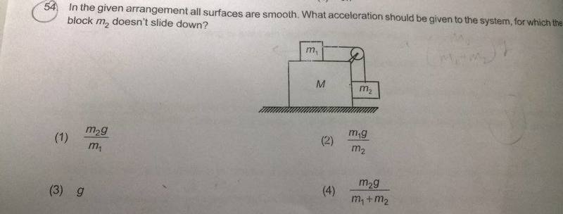

Physics problem diagram: block m1 on top of block M on a smooth horizontal floor, with block m2 hanging on the side of M via a pulley over a string; answer options (1) m2g/m1, (2) m1g/m2, (3) g, (4) m2g/(m1+m2).
a= (m2g)/(m1+m2)
Which is option 4.
But the answer doesn't match
Doc Al said:
Show how you got your answer.
The formula for acceleration here is:
m2g/(m1+m2)
So shouldn't that be the answer?
m2g/(m1+m2)
Why do you think that is the formula? How did you derive that?
For m1:
T=m1a
the normal reaction force in the upwards direction = m1g
For m2:
m2g-T=m2a
so,
m2g-m1a=m2a
m2g=m1a+m2a
so acceleration = m2g/(m1+m2)
Priyadarshini said:
For m1:
T=m1a
Note that the acceleration here is the horizontal acceleration.
For m2:
m2g-T=m2a
Here the acceleration is the vertical acceleration. (What must that equal?)
