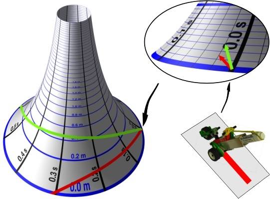

Why does curved spacetime cause objects with mass to accelerate towards each other?
If I placed a massive particle next to a larger massive object, at rest with respect to the large object, shouldn't the particle stay at rest?
Er...
GRAVITY causes masses to accelerate towards each other. In a Newtonian framework, gravity is a FORCE, which causes objects to accelerate towards each other according to F=ma.
In a General Relativistic framework, gravity is a curvature in space-time. Particles follow trajectories in space-time (also called world-curves), e.g. (ct, x(t), y(t), z(t)) and these world curves are determined by the geodesics of the space-time. You will find that the geodesics or world curves are such that massive objects are accelerated towards each other (almost the same way they are in Newtonian gravity, with larger and larger discrepancies occurring for larger and larger curvatures).

In its simplest form, we can consider just one dimension of space which gives us a two-dimensional spacetime, which is just a distance-against-time graph.
Without gravity, we draw the graph on flat paper. Objects moving freely (with no force on them) have graphs that are straight lines.
With gravity, we draw the graph on a curved surface. Two objects that begin at rest relative to each other have worldlines (graph lines) that are initially parallel, but the curved surface causes the lines to converge or diverge further along.

DrGreg, I was thinking about curved spacetime as in the picture on the link you gave when I asked my question. I understand how a moving object follows a straight line along the curved spacetime. What I am wondering about is why an object that is placed at rest (say, 1 meter above the earth) would accelerate towards the Earth (I guess both would be accelerating towards each other). For example, in the curved spacetime cone in the picture, the placed object is at rest 1 meter away from the earth, and since it is not moving, it isn't following the curvature toward earth. So why does it accelerate toward earth?
Does curved spacetime cause the object to sort of slide toward earth?
You're thinking about curved space, not curved space-time. Curved space only causes moving things to accelerate. Curved space-time is also curved (typically by approximately the same amount) with respect to time, so when you plot position in space against time in equivalent units you get the same curvature, corresponding to an acceleration.
No, thinking along lines like that is wrongfooting yourself.
What you seem to think of is the cone as an inclined surface, with a force causing objects placed on it to slide in some direction.
The image of the cone does not have that purpose at all.
Here the entire base of the cone represents a single point. You throw an object straight upwards, and it fall right back in your hand.
The line along the surface of the cone has the following property. At every point along the way the line does not curve right or left relative to the local surface. The line curves back down because of the curvature of the surface as a whole.

Jorjy said:
Yeah, I think my problem is that I'm not considering the time component of spacetime..
It's difficult for me to conceptualize curved spacetime. Even the cone is confusing to me because the time coord wraps around to meet back at the original point.
The "cone" shape is an analogy, and like all analogies you can't push it too far. Time doesn't really go in a circle, so the analogy isn't perfect.
