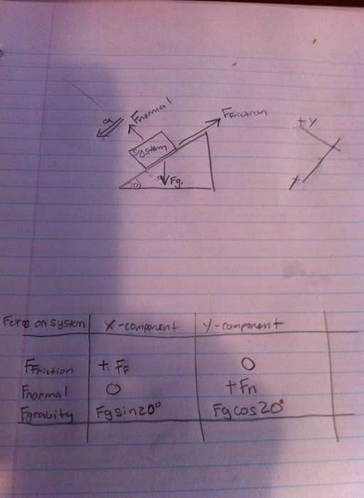

Please refer to the diagram. I have having trouble with B: "Determine the acceleration of the system. Explain your method, and identify and laws you are applying"
Ok so for A:, I drew two FBD's. For package A there is Fg, Fnormal, Ffriction, and F from box B - Correct?
Box B - Fg, Fnormal, Ffriction, and FfromboxA - Correct?
So now B is where I am having trouble. I am not sure how to find the acceleration of the SYSTEM ?

Newton's 2nd law. (Analyze force components parallel and perpendicular to the incline.)
Well, box A in front has a higher coefficient of friction, and so it will always be moving slower than box B. So the motion of box B is affected by the motion of box A, and vice versa (i.e. box B is pushing on box A because box A won't get out of its way).
So the motion of the system is really determined by the motion of box A or B, since they move together. When you draw the FBD of box A, first assume that box B isn't there, and include all relevant forces, then add in the force box B exerts on A, and that should describe the motion of the system.

You need to write your equations of motion for each box. After doing this what do you have in the inclined direction? Remember Newton's third law...

Ok drew it out, with coordinate system, and a table. Not sure if this is correct. Can yuou look over my table?
Draw them out as separate and draw Free body diagrams then equations for each block. Your table looks ok for the entire system but you should label 'Fgravity' as 'Fparallel' or something like that indicating that it acts parallel to the ramp. The value of 'Fgravity' is just 'mg' and it acts vertical. On the other hand 'Fparallel' and 'Fperpendicuarl' are the components of 'Fgravity' in the x and y directions.
By the way you can solve for the acceleration of the blocks by solving it as a system vs writing equations for each block. But then you will still have to write and equation for one of the blocks to find the force 'F' that acts between them...
So, if I go the system route, is my table correct?
To add to my table the ma of x would be what? and what would the ma of y be?
Can anyone confirm my table is correct?
what is the ma of x and the ma of y
Still don't know how to find those :(

How are you able to find the frictional force on the system?
Its just the sum of the friction forces for both blocks. I was not 100% sure how the system approach would work but it seems that if you do it as a system it is the same as if you wrote an equation for each block and added them together canceling out the interaction force 'F' between them.
