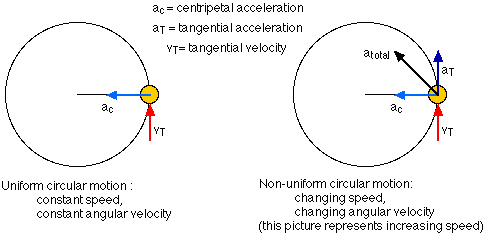

A particle moves along a circular path of radius 6 m, with constant linear acceleration of 1 m/s/s. Determine its total acceleration after 2 seconds.

This appears to be either a high school physics or a college freshman physics problem. If so, then by "total acceleration" I presume they mean centripetal and tangential components of acceleration. Check your physics textbook for the discussion of centripetal or circular motion (not to be confused with rotational motion, that is different). The relevant equation for centripetal acceleration should be there.

Be that as it may, below are a couple of online references for acceleration of particles that move in a circle. But first, some important things to keep in mind are:
1. The velocity (a vector) always points in the direction tangent to the circle, no matter where the particle is on the circle. We call this the tangential direction.
2. The acceleration (also a vector) can have one or two components. It always has a component toward the center of the circular path (the centripetal acceleration), which causes the particle to curve to the left or right. And it may or may not have a tangential component (in the direction of the velocity) -- it does if the particle is speeding up or slowing down, as in your problem. If the speed were constant, then the tangential acceleration would be zero.
You can find out more of the basics here:
http://en.wikipedia.org/wiki/Acceleration#Tangential_and_centripetal_acceleration
http://theory.uwinnipeg.ca/physics/circ/node6.html
Hope that helps. Once you understand better what's going on, solving this problem pretty much begins with figuring out the speed of the particle (that starts from rest :smile:) after 2 seconds.
