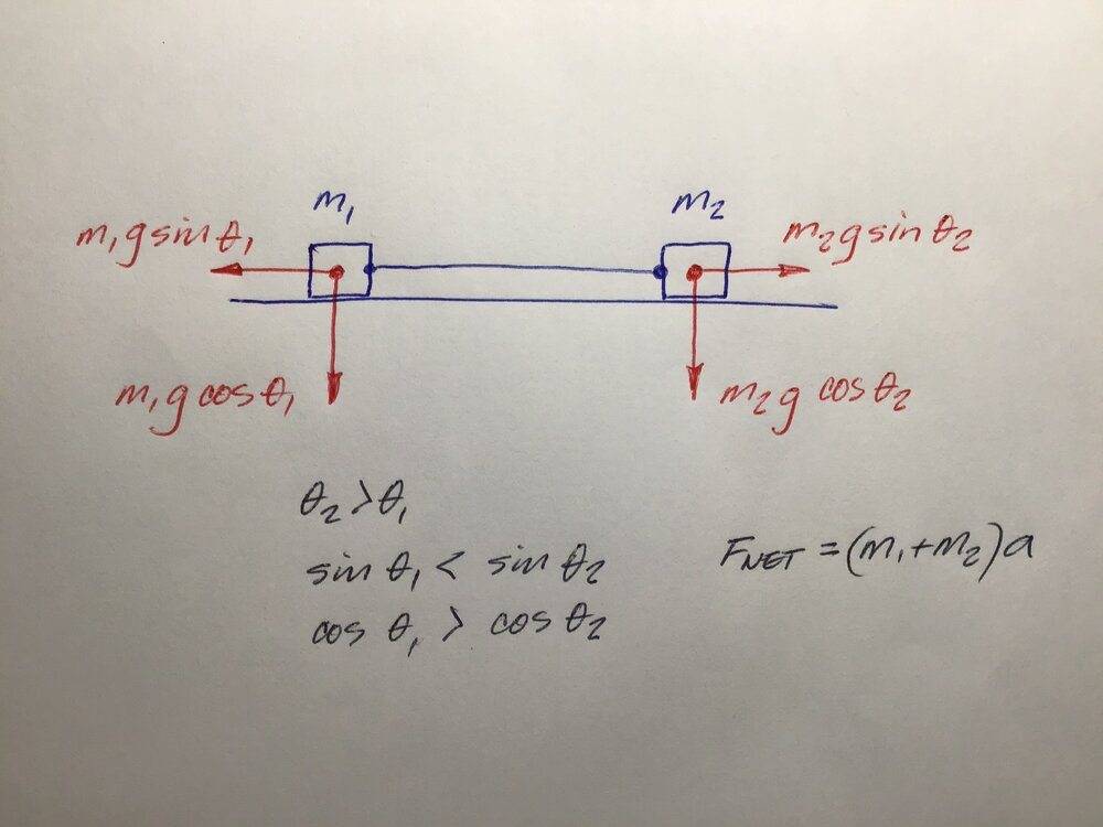

songoku said:
If the value of ##a## is negative, this means that actually ##m_1## moves upward.
You could assume that with a velocity, but not with a rate of change, which is what an acceleration is.
Negative rate always means that the value is decreasing.
A negative acceleration always means that the mass is slowing down.
I like to simplify this type of problems as two masses sliding on a horizontal surface, while attached to each other by a string.
