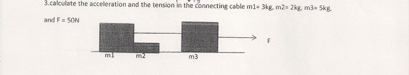

Does the total Force F=50N divide evenly between m1+m2 and m3? Meaning the tension between m1/m2 & m3 is 25N given m1+m2=m3. Also, is the acceleration between m1/m2 & m3 the same as the acceleration at m3?
a=50/.098=510.2
a=25/.049=510.2
Have you tried drawing free body diagrams, or do you feel like you have advanced beyond the point where you need to draw free body diagrams?

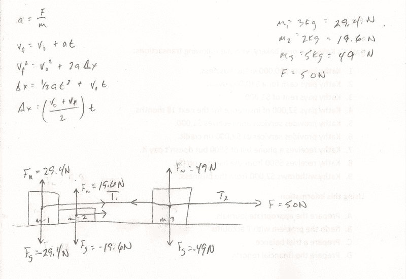

Robb said:
Guess I'm not sure about displacement and velocity.
Robb
I don't see any force balance equations on any of the masses. Let T be the tension on the cable, and let f be the contact force between masses 1 and 2. Let's see some force balance equations (in the horizontal direction). One equation for each mass.

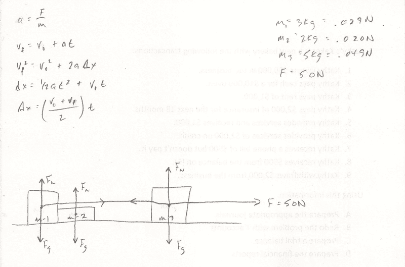

Robb said:
You say that 3 kg = 0.029 N,
2 kg = 0.020 N,
5 kg = 0.049 N.
This doesn't make sense to me. What are you doing to come up with this?
Sorry for the bad conversion! Anyway, we have learned zero about contact force (engineering physics 1) so not sure about that. .098 is m1+m2+m3 and .049 is m1 + m2.

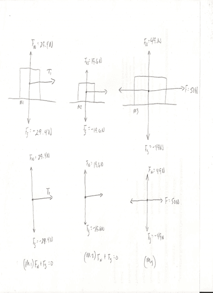

I want a separate free body diagram for each of the masses, and a separate force balance equation for each of the masses. Didn't they teach you to do this in your course?
Chet
Is this more like it?

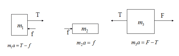

No. That's only slightly like what I had in mind. Here is what I really had in mind:
Please tell me if it makes sense. If not, please pose questions. Also, now please solve these equations for a, T, and f.

The solution to this problem involves taking the three linear algebraic equations in post #12 and solving for the three unknowns, a, T, and f. This is a 9th grade algebra problem. The easiest thing to do is to add the three equations together; this eliminates T and f immediately, so that you are left with an equation for a. What is the algebraic solution to this equation for a (in terms of m1, m2, m3, and F)?

If you are good at math, you should be able to add my 3 equation together. What do you get? No, the.tension is not zero
I think I understand that. Basically they null each other mathematically. So if the acceleration is constant then the acceleration at m1/m2= acceleration at m3?
adding them and solving for a I get a=F/(m1+m2+m3)= 50/98= .51m/s
m1a=T-f
m2a=f
T=a(m1+m2)=(.51)(49)=25N
The part above is correct.
= 50/98= .51m/s
This part is incorrect. m1= 3, m2 = 2, m3= 5; (3+2+5)=10, not 98. Where the heck did the 98 come from? 50/10 = 5 m/s2
m1a=T-f
m2a=f
T=a(m1+m2)
=(.51)(49)=25N
m1=3, m2 = 2
=5(3+2)=25
