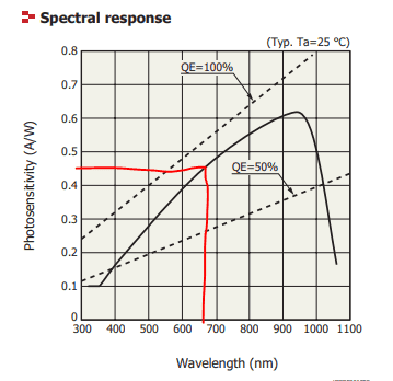

This detector looks good! Here's how you can tell:
Look at the spectral responsivity curve in the datasheet, and see what the responsivity (in amperes of photocurrent per watt of incident optical power, so A/W) is at the laser wavelength of 660nm:
The red markup is me. You can see the responsivity (they call it photosensitivity, I've always seen it called responsivity) is about 0.45 A/W. So the full output power that S&K diode, which was 0.9mW, will produce 405##\mathrm{\mu A}## of photocurrent.

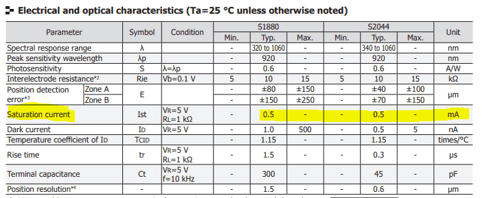

Now look at the following table:
Notice that the saturation photocurrent is 0.5 mA. This means that with the full power of your laser (0.9mW, which creates 0.405mA of current), you will be using 80% of the dynamic range of the detector. That's a nice, beefy signal to start with.
It's not clear to me exactly how good a position resolution you will get with your setup, but based on their specification and the conditions they measured it in, I would be surprised if you saw much worse than a few ##\mathrm{\mu m}## resolution.
I don't know how fast an AFM moves, but one other thing to maybe check with your advisor or coworkers is whether 1.5 microseconds rise time is fast enough.
