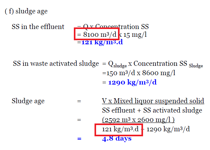

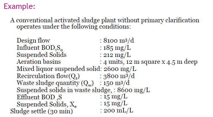

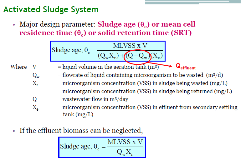

for this question i think the sludge age is wrong.
Based on the formula given , The suspended solid in effulent should be = (Q-Qw) , which is 8100-150= 7950 , am i right ? Correct me if i am wrong ...
Or the 8100 m3/s given is the flow of effluent ?
