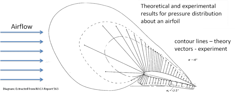

By the way, it is more correct to say that lift is caused by suction over the top surface of a wing. There is a large drop in pressure as air flows over the top of a wing - see the attached diagram (adapted from NACA report 563, also attached). The long vectors over the top are pulling on the top surface, a suction. The shorter vectors pushing on the bottom are indeed the higher pressure from slower fluid flow. See how much more suction there is compared with the push from below. The same diagram also compares experimental results with theoretical calculations (each contour line has different simplifications and assumptions, while the vectors are measured results). As you can see, the overall shape is correct, but better assumptions agree better with measured results. See the report for more details.
