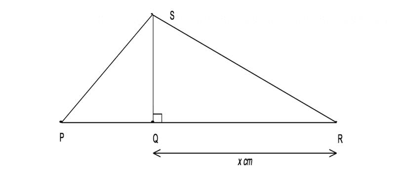

In a diagram, P, Q and R lie on a straight line and angle SQR is a right angle. The lengths PS, SR and RP are a, b and c cm respectively and QR is x cm.
Use algebra to show that x = (b^2 + c^2 - a^2) / 2c
and attempt at a solution[/B]
Do I need to use Pythagoras for this question? I need a prompt, a little help please...

Beats me. Do you have a diagram to refer to? If not, you should make one, based on the description of the points.
Since there is a right angle involved, I would keep Pythagoras handy, nevertheless.
I have attached a picture of the triangle in question... Hope it worked...
Drawing a line from the right angle perpendicular to the hypotenuse divides the original right angle into two triangles both similar to the original triangle.

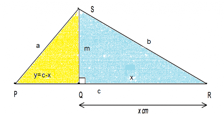

Yes, you can solve the problem by using Pythagoras' Theorem for both the yellow and blue triangles.

Got it!
After some working I got...
a^2 - c^2 +2cx -x^2 = b^2 - x^2
which simplifies to:
Thanks ehild I equated the m
well done!
