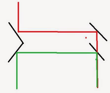

I also found this solution
The black lines are the mirrors. The red and green are the light sources.
But not sure what kind of the mirror is that lower right mirror.
Does anyone know??
In this configuration the mirrors are set as 45 degrees.
You need a half silvered mirror, also known as a stereoscopic mirror. Obtainable from this link that I found. And others,I'm sure. It seems that a 2" X 2" mirror would be $12. Not cheap but these claim to be high quality.
Thank you for your reply.
Do you mean that the lower right mirror is stereoscopic mirror and all others are common mirrors?
You only need a stereo mirror when you want two paths for the light. In your diagram, all but one mirror are fully reflecting. Have you Googled anywhere else? It would be a good idea to read as much as you can.

I was trying to get more info. It seems you can use other mirror setups but the input images are fixed to their 180 angle. So a Beam splitter is not ideal.
Jane11 said:
I also found this solution...
The solution will work just fine,just remember that the bottom image exits mirrored while the top one does not, if that does not present an issue all you need is the above mentioned half-mirror.
