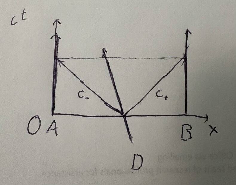

So like this?
Where the observer O is at rest and colocated with detector A. Detector B is some distance away. A flash of light to the left C- and a flash of light to the right C+ are emitted when the moving guy D passes the emitter in between A and B. The flashes C- and C+ arrive at the detectors A and B at the same time in O’s frame.
Do I understand the scenario? How do we determine if D dies?

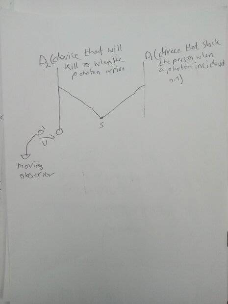

The scenario is mostly right but who will die is the rest observer o and there is another observer o' at his left and moving towards him

  • #33
O' is me who made this experiment because he wants to understand 🙂
If I made the experiment such that at some position when I reach this position two photons will be emitted simultaneously from the middle they will reach the two devices simultaneously relative to o but not o'(which is me) does that mean he will be dead in his frame but still alive in mine because the photon will take more time to reach the device relative to me also can I save him?
And s is a source of photons🙂

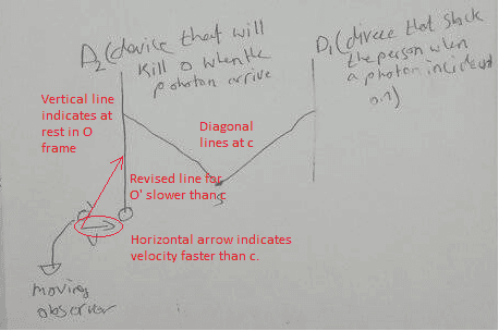

There is one mistake in the diagram. As drawn, you have O' moving faster than c. I have drawn a suggested revision that hopefully captures your actual intention.
In spacetime diagrams vertical lines represent things that are at rest in the diagrammed frame, lines at 45 degrees represent pulses of light. This is using the usual convention that the vertical axis is ##ct## and the horizontal axis is ##x##. Objects with mass that are moving in the diagrammed frame will have lines that are between vertical and 45 degrees.

  • #36
Thank u I appreciate that and yes it was by mistake but I only wanted to show that me is moving to the right...

OK, so notice the colored events here.
If the green event happens before the blue event, then O' can rescue O. All frames will agree if the green event happens before or after the blue event.
The yellow event cannot have any effect on that because in order for any information or influence to get from the yellow event to the blue event, it would have to go faster than light (line more horizontal than light on the diagram). Frames will disagree if yellow or blue happens first, but it doesn't matter. Yellow happening or not cannot influence anything at blue.
