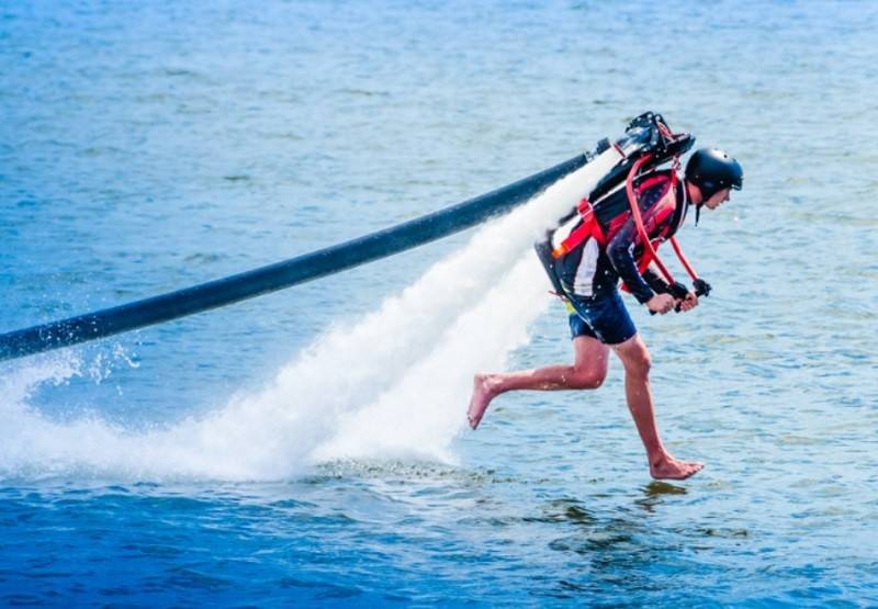

Have you considered using water? Search water jet pack for a number of commercially available systems. Here's one that looks like it would be fun:

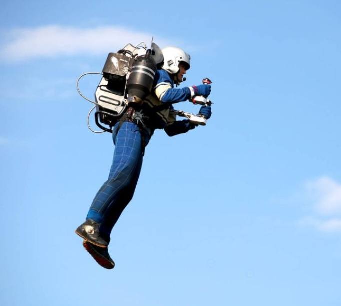

Jet packs using air are also available. Search jet pack to learn more. A number of people are working on this, but it is much more difficult because of the volume and velocity of air needed to get lift. Realistic solutions involve high power ducted fans or jet engines. Safety is a major challenge because there is no backup system if the power source fails and human bodies get damaged easily.
