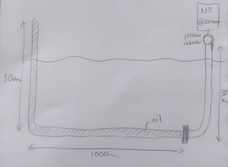

Hello,
I am trying to solve a problem where I want to know how many cylinders of N2 (50L, 200 bar) are needed to flush a pipe filled with oil.
The pipe diameter is 0.5", so the volume of the pipe is 0.133 m3 (with a length of 1050m) which is filled with oil.
Behind the N2 cylinders is a pressure reducer which can be set from 0-10 bar.
How can I calculate the number of cylinders I need of N2?
I need to overcome the height of 50m + 1 bar, so around 6 bar. Let's say I set the pressure reducer to 10 bar and flush the pipe, then it contains 0.133 m3 @ 10 bar = 1.33 m3 @ 1 bar.
If, let's say the last 15 bar can't be taken out of the cylinder, it contains effectively 9250 L @ 1 bar = 9.25 m3 @ 1 bar.
Can I just compare those two and say 9.25 > 1.33, so only 1 cylinder is enough?
Thanks in advance!

Well, the basics of the gas volumes and pressures are straightforward. The pressure at the bottom is from the vertical column of oil. Boyle's Law will tell you the volume of compressed gas at 200 Ats that will occupy the volume of the pipe (one vertical plus the horizontal length) at the necessary pressure (if the temperature stays more or less constant). A small excess pressure will push the oil out of the top. Once the oil starts to be expelled ( if no bubbles have formed), the hydrostatic pressure will go down as the height of the column and the gas pressure will drop according to Boyle's law. It won't change a lot because of the small total volume of the pipe.
The hydrostatic pressure will approach zero (plus 1 At, of course) and the gas pressure in the pipe will not change much if there is 1000m of horizontal section (1030m of gas goes to 1080m. I think the volume that you need to consider which needs to be at 50m of oil hydrostatic pressure is the 1030 length (vertical down pipe plus horizontal run) - the gas will then expand into the upward 50m section of pipe and no more needs to be pumped in.
The 'pressure reducer' would be followed by a simple tap which should be shut off as soon as oil starts to emerge. All that is necessary is for the pressure reducer to output a pressure which is a bit in excess of the 50m + 1 At and nothing too 'exact' and that's only for safety reasons, I think. (You could in principle use the 200 At bottle directly if you were careful about controlling the gas out of it. You wouldn't want to burst the pipe! You should never have 10At of pressure in the pipe; just enough (your 6Ats estimate)
Ok, let's break it down. Boyle's law: pV=nRT and let's assume nRT=constant for the N2 quad. That would mean that pV = constant as well and is equal to 200 bar * 50 L = 200 bar * 0.05 m3. So let's assume I want to output the N2 at 10 bar, then I would have p2*V2=p1*V1, so p2=200 bar * 0.05 m3/10 bar = 1 m3?
This would mean that I have enough N2 in 1 cylinder as the volume of the pipe is 0.133 m3?
And so I would need a second cylinder of N2 when the length exceeds 8000m? The volume of the pipe would become 1.013 [m3], so this is larger than the 1m3 calculated and thus I would need a second cylinder?
Am I right in these calculations?

About the 10Ats thing. You have to ask yourself if the pressure will ever need to reach 10Ats. If you let the tap open with a bang then yes. But would you want to do that? It would just accelerate the oil at a high value, sending it out of the end of the pipe at an excessively high speed and that is not necessarily a good thing - probably a bad thing (?). The working pressure in the pipe needs to be no more than a little greater than the hydrostatic pressure for 50m of oil. This is why I say that you do not need the volume at 200 At that you think you do.
So I would say that your calculation should be on the lines of
Pressure in Cylinder X Required Volume of Cylinder > Volume of 30m + horizontal run X Hydrostatic Pressure of 50m vertical
Notice I have not included your 10Ats figure because it should/need never apply.
