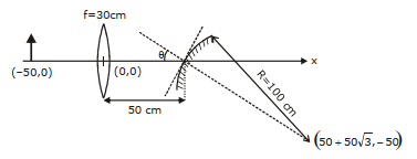

A small object is placed 50 cm to the left of a thin convex lens of focal length 30 cm. A convax
spherical mirror of radius of curvature 100 cm is placed to the right of the lens at a distance of 40
cm. The mirror is tilted such that the axis of the mirror is at an angle θ = 30º to the axis of the
lens, as shown in the figure.
If the origin of the coordinate system is taken to be at the centre of the lens, the coordinates (in
cm) of the point (x, y) at which the image is formed are
(A) (0, 0) (B) (50 – 25##\sqrt{3}##,25) (C) (25,25##\sqrt{3}##) (D) (125 /3,25##\sqrt{3}##)
The usual formula in Geometrical Optics.(Although I'm doubtful if they are applicable to this problem)
This problem was asked in one of the most prestigious exams in India: JEE Advanced, unfortunately it was considered to be ambiguous for the scope of given examination and hence no official answer is issued for it as such.(BONUS marks to all)
And so many solutions were posted on Internet which are conflicting in physical principle with each other.
(i) Some are able to arrive at the (supposedly) correct answer (C)(25, ##25\sqrt{3}##) (during the time of their publication) by applying mirror formula and assuming that rotation just changes orientation of reflected ray and preserves length, so image formed(by spherical mirror) is such that it radius vector is 50cm from mirror vertex just oriented 60 degree axis and proceed to do little trigonometry to arrive at answer.
(ii)Some of the solution on internet(again during the time of their publication) , first calculate the image formed by lens and then go on to calculate the image projection on the (now tilted) axis of spherical mirror, using that projection on axis as image, they apply the mirror formula , and locate the corresponding image which comes out in terms of some nasty surds and then assume since the only option closest to their answer is (C) hence they option C is correct
(iii) Recent one assumes this was a wrong question(hence awarded BONUS) as it was out of scope of syllabus.

There appear to be some mistakes in the question which could cause confusion.
BlazenHammer said:
Homework Statement: ... A convax [sic] spherical mirror ... is placed to the right of the lens at a distance of 40cm.
But the diagram shows this distance as 50cm.
BlazenHammer said:
On this diagram, the coordinates of the mirror’s centre are shown as ##(50 - 50\sqrt3 , -50)## cm. Check the x-coordinate.

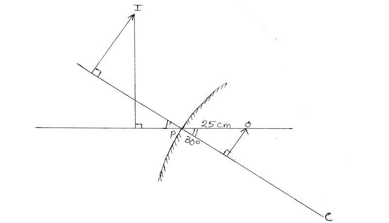

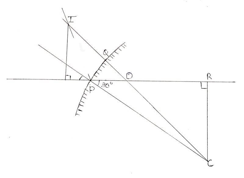

I think method (ii) is the approach in my first post on the other thread
Here the axis is tilted at ##30°##
haruspex said:
Taking a horizontal axis is wrong because of spherical aberration. One must take the axis as the line through the object and the centre of curvature.
While this one is the one we finally used:
Here the axis is through the object and center of curvature
In either case, the answer doesn't match

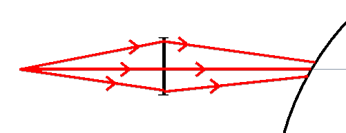

Yes, but which rays? If you pick the wrong ones, spherical aberration could lead to a significantly different answer.
The original diagram is badly drawn. If we consider a point source and a lens with diameter much less than the mirror’s, the set-up looks like this (incident rays in red):
Although the 3 reflected rays (not shown) won’t be exactly concurrent due to spherical aberration, they will still give a decent indication of the image position.
Steve4Physics said:
The original diagram is badly drawn. If we consider a point source and a lens with diameter much less than the mirror’s, the set-up looks like this (incident rays in red):View attachment 346909
The trouble with that approach is that the answer then depends on the diameter of the lens. The rays you have drawn will not converge very well after reflection in the mirror, while rays from higher up (through a wider lens) will converge better at a slightly different place.
On the other hand, we then run into spherical aberration at the lens. Where the most convincing final image will appear is hard to say.

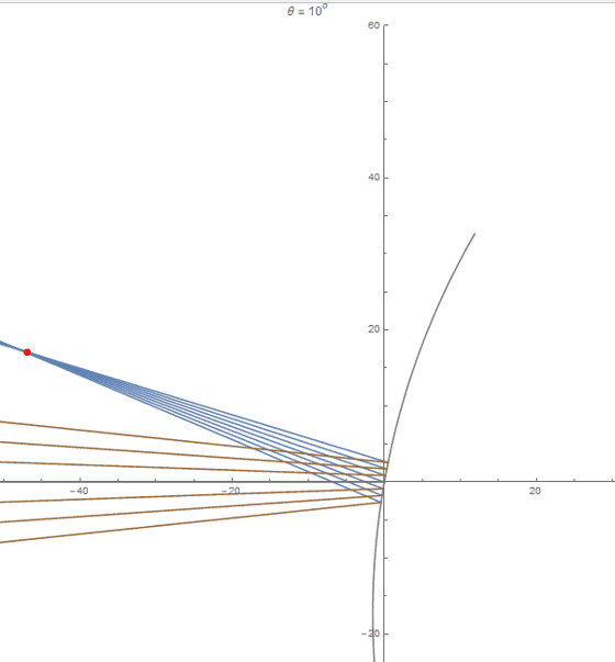

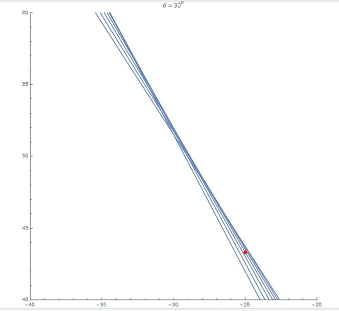

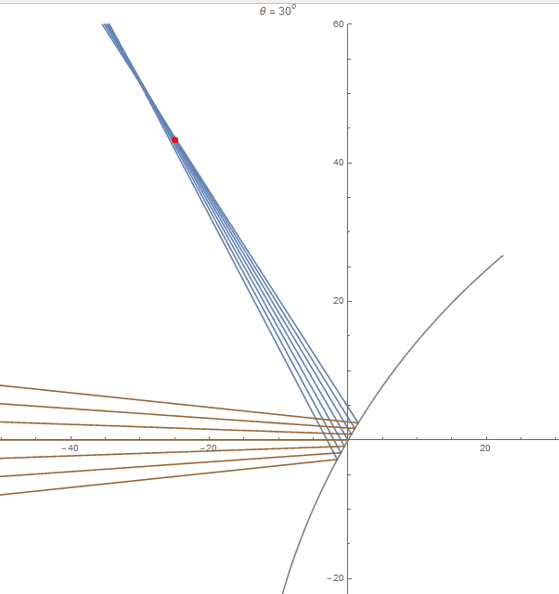

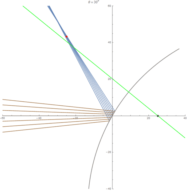

Here are some ray-tracing diagrams that are "exact" if I didn't make any errors. The brown lines are rays incident on the mirror and the blue lines are the reflected rays. The maximum angle that the incident rays make to the horizontal is 6o. So, they are fairly "paraxial" relative to the optical axis of the lens.
I took the origin to be at the mirror in these diagrams. Thus, the lens (not shown) is located at x = -50 cm. The brown rays would intersect at x = +25 cm if the mirror were absent.
The mirror is rotated by θ = 30o. The red dot is the image location calculated by method (i) of the OP. This is the method where you take the image formed by the unrotated mirror and rotate this image by ##2 \theta## clockwise about the origin.

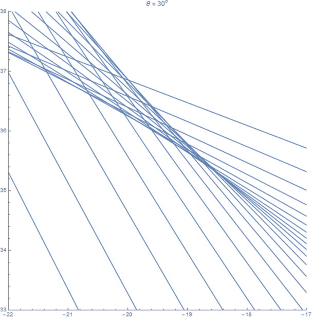

The picture below zooms in. The reflected rays do not cross at the same point due to the spherical aberration.

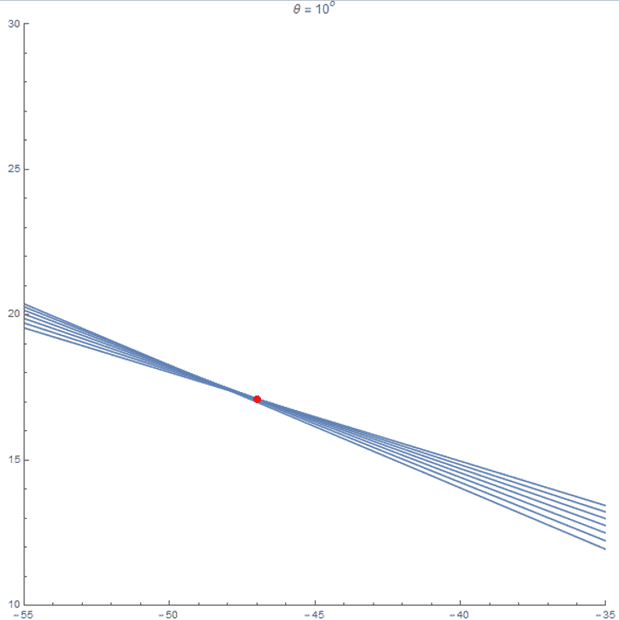

Reducing the mirror's rotation angle to 10o, we get the pictures below. Now there is less spherical aberration and the red dot is closer to the actual image.

Interesting… but something is not right.
You have taken the lens to be ideal, no spherical aberration. That's fine, but it means you can allow a very broad lens and have rays coming down onto the mirror from the left, headed towards the primary image, at all angles short of the ‘vertical'. This allows us to put aside how these rays came to be and just consider the primary image as the source.
For the usual spherical mirror formula, the primary axis meets the mirror perpendicularly.
That makes it roughly 40° to the horizontal here, and puts the source much closer to the mirror, about 20.7cm. The focussed image is correspondingly closer on the other side of the mirror, about 35.2cm, and a very similar distance from the x axis.
The final image is at about (-18.4, +35.2) in your coordinates.
This trend is already indicated in your ray trace. The bottom two brown lines reflect to intersect at about (-33, 57), while the top two meet around (-28, 47).
If we take the lens to be of limited aperture, the set of rays is arbitrarily truncated short of the focus calculated above.
What will happen with a spherical lens is not clear to me. Certainly not a sharp image, but where sharpest?

Method (ii) is very unclear. At first, I thought it matched my approach, but the wording "calculate the image projection on the (now tilted) axis of spherical mirror" bothers me.
Is it saying drop a perpendicular from the primary image to the tilted axis (PC in your post #15) and take the primary image as being there? I can’t think why anyone would suggest that.
@TSny's ray tracing is different again. It effectively finds an image produced by spherical aberration, the rays that would normally have produced the final image being unable to reach it. It's analogous to blocking out a central disc of a (spherical surface) lens and looking for the image produced by the ("aberrant") peripheral rays. The answer depends on how wide you take the lens to be.

In the first two images of @TSny 's ray diagrams, ##\theta## is ##30°## then the :
Image position calculated by method (i) is represented by red dot
The red dot seems far from the point where maximum rays intersect or are closest
In this image for angle of thirty degrees, the red dot seems far away from the the region where the rays are closest/where maximum rays meet
Sure, but I would not have called it a huge difference. Options A, C and D are all further from the ray tracing result. And I am not ready to call any of the answers correct. The question is poorly thought through; the answer you get depends what you consider to be a valid image.

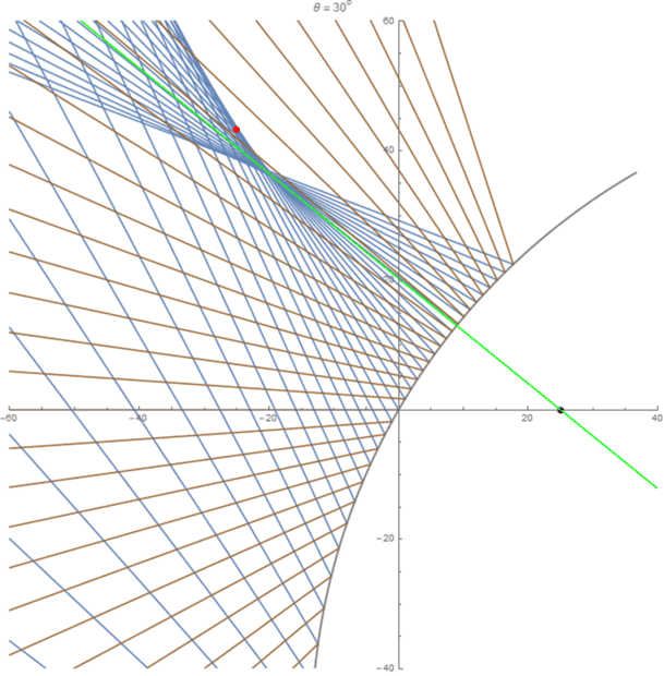

Ok. I thought it was natural to assume only paraxial rays for the lens.
But, we can consider additional rays coming from the lens at larger angles to the horizontal. Here are some plots. I've added a green line to indicate the optical axis of the mirror that passes through the image location of the lens at x = 25.
The following graph is essentially the same as I plotted before which restricts the lens rays to almost horizontal:
The graph below includes "steep" rays from the lens that encompass the green optical axis of the mirror.
The rays paraxial to the green axis give a sharp image near your calculated position of (-18.4, +35.2).
Here is a closeup:
