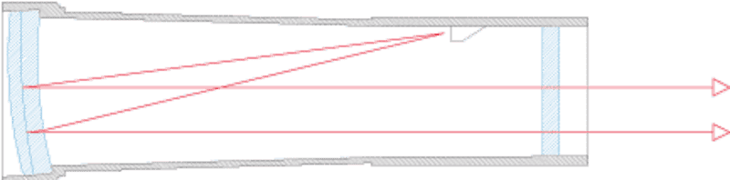

Hello,
I wanted to confirm a suspicion with how the Aimpoint optics work, but to do that I need to do some ray diagrams. I only ever did them with simple convex, concave, and spherical systems while at college.
From what I already know of how reflex sights work, the LED is placed at the focal point and is reflected off a spherical lens, typically a concentric spherical lens. The concentric nature of it permits light to be minimally distorted from the target. The goal is to get all the rays to reflect parallel with the gun bore axis.
My limited understanding is that while it is at the focal point this is true; but gun sights are adjustable. Aimpoint claims their two lens system is parallax free (below is their diagram), so I am assuming the second lens (correct lens) has to do with making the rays be parallel no matter where the LED moves (to an extent). However I want to prove this with ray tracing it at maximum and minimum adjustment values.
If anybody could help guide me with how you would do a ray tracing diagram for this type of system, it would be really appreciated!

Do you have any specifications on the lenses used? The lens on the rear of the sight appears to just be a flat piece of glass, which wouldn't have any effect on the light coming through after it reflects off of the mirror. So that wouldn't do anything to help the sight.
In what way are they adjustable?

As for how they are adjustable: the source of the ray's in the diagram is the LED positioned as shown. But that is only in 1 case; that LED can move up, down, left, and right typically up to 80 Minute of Angle clicks. Doing that changes the ray diagram. That is why I wanted to see if a corrective lens is able to make the ray's parallel at both the maximum, minimum, and ideal positions. Since the lenses are symmetrical in the X and Y directions, I only have to look at it in terms of one axis. Unfortunately the patents I have found and read do not say anything on whether the correction lens does this or not.

In any case, if we simplify this down to a spherical lens and a point-source of light placed at the focal point, you don't even need to raytrace. All the light will be parallel after reflection. So as you move your eye around the optical window the dot or reticle always appears to be directly along the sight's optical axis, just offset slightly, with the amount of offset equal to the distance your eye is away from the axis. The sight's optical axis being the middle of the window and parallel to the lens' true optical axis, which runs along the top of the sight.
Basically, imagine putting your eye up to that diagram. The incoming rays will always come in from the same angle, no matter where you put your eye. Since this angle points along the optical axis, which is either parallel to, or at at set angle to the gun barrel's axis, the sight always points very close to where the barrel is pointing, regardless of your eye placement. Moving your eye around the sight doesn't change the angle of the sight compared to the barrel, unlike what happens with iron sights, so, at worst, you've only introduced perhaps an inch or two worth of error in your shot, even if you move your eye all the way from one edge of the sight to the other.
I'm guessing that proper shooting technique essentially eliminates almost all of this parallax by keeping the eye in nearly the same place at all times, so distance shooting is easily possible even though some parallax remains. Any variations in eye placement between shooters is easily compensated by adjusting the sight.
That's my limited understanding of it all. As always, someone correct me if I'm wrong.
This part I understand. The problem that I don't understand is when you move the LED to align the bullet impact point with the reticle. The rays won't be parallel like when it is at the focal point, so the parallax is formed. One of my friends who builds firearms thinks it is negligible; on the other hand the newest sight designs coming out feature that corrective lens system shown in the first picture. Although they don't state the corrective lens redirects the LED's light to all be parallel upon bouncing towards the users eye, I assume that is what it does, or it would seem pointless to add another expensive lens to the system? And that is why I wanted to do the ray tracing to see if my suspicion is right or if they are correcting something else that seems negligible with the corrective lens.

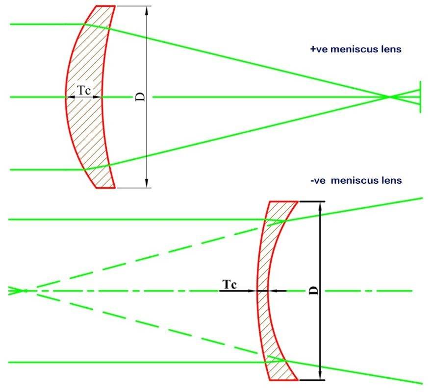

When I input my lens data, it doesn't describe where the thickness of the lens will be; is it always at the center or is it the tops?
It's almost certainly the center of the lens.
Ozen said:
And what determines how tall the lens will be (D)? Where can I find this value?
The software that I've used before has a radius or diameter input that you specify for each surface.

Might I suggest starting with a thin-lens design first? That way you don't have to worry about all these details. All we're really interested in is how the rays behave as you change the position of the LED. A parabolic or spherical thin-lens should work just fine to start with.

I am unsure how to even create the thin lens design in Synopsys(TM). I imagine it would just be a reduced thickness; but the other parameters don't make much sense to me. Like the pupil wizard as I said makes no sense, for reference the coding line for it in the tutorials is "OBB 0 5 12.5". I know OBB is selecting the dimensioning method and 0 makes the object at infinity, but 5 and 12.5 seem like random inputs to me (units are degree and mm).
https://www.osdoptics.com/files/SYNOPSYS(TM)%20Lens%20Design%20Software%20Starting%20Guide.pdf
Here is the link to the guide I've been following if that helps. On page 12 it shows the Lens Spreadsheet where I can change data and enter fresh data. As you can see there is no (D) dimension listed, only radii for the surfaces and thickness. As for the LED, I haven't the slightest idea on how to put that into the software.
Hmmm. I see what you mean. I don't think the dimensions matter to be honest. Whether it's millimeters, inches, or miles the geometry is the same. I remember seeing a couple of options for choosing dimensions as I browsed through the manual, but these shouldn't change the results of the ray trace.
