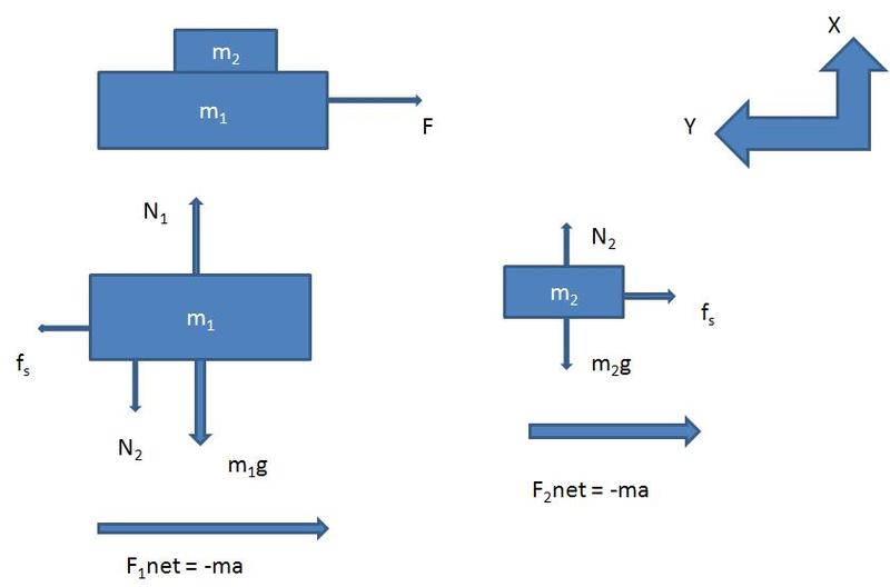

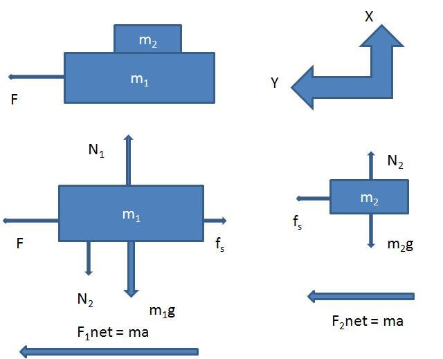

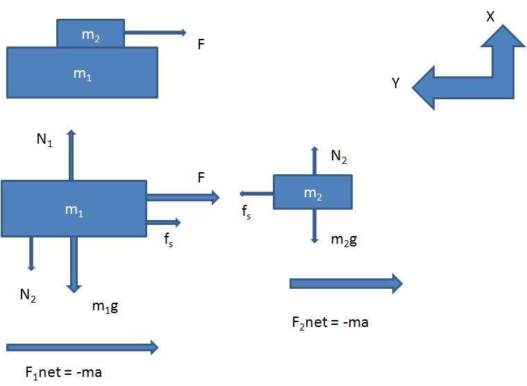

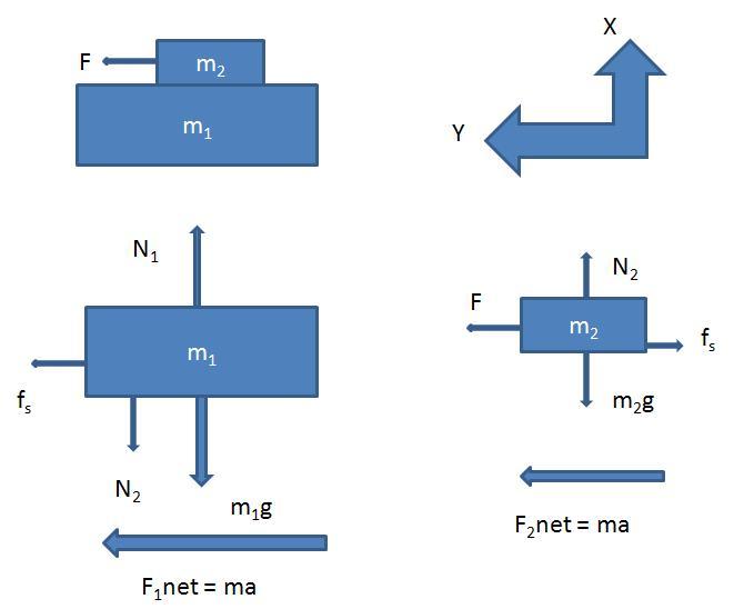

So, I have created some blocks, and draw the FBD myself, am not sure if I did it right or not, so I'm going to upload these FBD here, and hope you guys can correct me if I'm wrong. Thanks a lot.
A block of m1 and m2, m2 is siting on top of m1. Assume there is no friction on the ground under m1, and there's friction between m1 and m2. Here are the FBD
and this is the last one.
Do these two m1 and m2 have the same acceleration ? I think they do, but I'm not so sure...
Thanks
