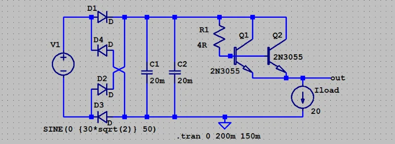

I'm setting up an analog power supply. I have the transformer bridge and filter capacitors so far. The transformer puts out 30 volts. I am currently using two parallel power transistors and a variable resistor to set the output. It also has a meter to monitor voltage. The question is this. How do I set up a single transistor to remove whats left of the ripple after the filter capacitors. It has to vary along with the control transistors to be constant in its ripple removing. The bases of the two power transistors to the potentiometer is currently the control.

The control transistors are up and running. I need a ripple remover circuit after the capacitor filter to remove the ripple. The ripple remove has to invert and insert the ripple to the control which is variable on the power transistor's bases. A transistor with a zener would work if the power supply weren't variable. The supply is for a solid state transmitter. Ideally, I don't want any ripple what so ever. I'm looking only for a single transistor ripple remover circuit. The ones in all the linear power supplies online seem to me to be completely absurd and overly complicated for their applications. I'm looking for simplicity. Something that works good easy to work on and reliable.
Your ripple remover must carry the full output current. It will need the same output current rating as the output power transistors, so why duplicate them?
Control the base of the power transistors to remove the ripple, and to regulate the output voltage. If you do not provide part numbers, I cannot design the base drive circuit that removes the ripple.

Please post your schematic. Use the "Attach files" link below the Edit window. Thanks.

Post your circuit diagram and I will show you how to eliminate the ripple.

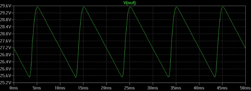

Here is the circuit you describe, and the ripple it will produce.
Thank you for all the help. Making and posting a schematic for something this simple seems to much of a hassle to me as I only need to connect two leads of a transistor up. Thanks anyway. I think I'll just go and try to figure it out by myself.
Hey, that's a good circuit diagram, only it's missing the ripple inverter transistor.
Then fix the diagram.
Get a copy of LTspice, it is free from ADI.

I doubt you can build a reliable power supply without documentation like schematics.
I've also done several of this sort of design and I believe it's more difficult than you think. I would have a million questions in a design review, but I'll just assume you've done the analysis (things like worst case temperatures, short circuit protection, turn on transients, capacitor ripple current, second breakdown of BJTs, etc.). I think you may have troubles ahead, but kudos for exploring, I think you'll learn a lot. Good luck.
Check out this old National Semi Audio-Radio handbook the appendix has a nice section on your rectifier/filter.
Anyway, it sounds like you would be interested in the capacitor multiplier circuit, although I've personally never seen it used at this sort of power level. Normally ripple reduction would be done with feedback to a reference, like the venerable LM723, or just op-amps.
