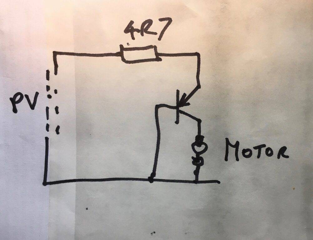

A small fan in my Weather Station unit stopped working.
A few years ago, I bought a Accurite weather station which has a wireless connection (not wifi) to a unit in doors. I was standing near it on a quiet sunny day and I heard a motor running. It turns out that is's a fan that blows over the temperature sensor to make sure it measures the actual air temperature. There is a small PV panel on top of the unit which provides the electric power when it's needed - smart, eh?
I found out about this in a forum or group. Someone mentioned having replaced the fan bearing so, when the fan stopped running a few weeks ago, I thought I would get inside and fix it mechanically. But the PV works and the Motor works when connected directly to the PV. There is a small circuit board between the two which seems to consist of a transistor, a resistor and two capacitors. The transistor number is too short to make sense of but the circuit seems to be as in the sketch. I am assuming the transistor is pnp. The question is what does the circuit actually do? Is it to limit the current to the motor or to use the thermal characteristics of the transistor to control more accurately when the motor starts driving the fan? There are capacitors at input and output too. The maximum output volts of the PV in the brightest sun I can find is just over 1.5V so the transistor is operating with low volts across it and those approximations that I remember using will not apply.

Are you sure there is no base resistor? And where are the two capacitors you mention?
This circuit will shut off the motor when the solar cell outputs less than -Vbe(on) volts.
They could be protecting the motor from heating when the voltage is too small to run it. It could also be a vestige from a battery backed model.
BoB
Probably the wrong schematic. That transistor will behave the same as a diode. Perhaps a 3-terminal voltage regulator? Which would limit the voltage applied to the motor.
edit: Look for markings like 7805, 7812, etc. LM78xx is by far the most common series of voltage regulators out there. Even though the markings are "short" if you post them we may be able to make sense of them.
As you have drawn it, it is a voltage regulator.
The series resistor is to current limit the base current.
The motor runs on Vbe which fixes the motor RPM while the Sun is up.
The motor current as needed by the motor, the remainder is shunted as base current.
I would expect it to be a darlington pair, maybe better suited to PV.
Measure the motor operating voltage to identify configuration.

This seems awfully complicated. It will almost certainly work without problems with the cell connected directly to the motor. You probably want to keep the capacitor across the motor to eliminate high voltage spikes from the commutator.

The only mark on the chip is 65e9 and an illegible icon. The 100 mFd Cs are across inputs and outputs.
Is it possibly there to inhibit the fan on a cold day? But that wouldn’t make sense afaics. The air temperature would always be good to know.
I can’t imagine the PV could fry the motor . I could go for the ‘heritage’ explanation.
I must say I’m inclined to leave the circuit out and connect motor direct (or with 4R7 resistor perhaps). Something has to be done as the temperature reading has always agreed with the BBC. Today it said 26C. Nonsense!

The motor rotates when the sun iOS bright enough to produce just over 1.5V (with the 'unknown circuit' not connected. I can measure no volts around the circuit except for at the emitter. If I could find a suitable replacement chip then that would be good but I can't see why the 4R7 resistor would not be enough current limiting.

Reverse Engineering is a devil. The motor is not near the sensor and when it's running, air hits the sensor before the motor so heat wouldn't be a likely problem. But you never know. Anyway, if I keep the 4R7 resistor always in series, I cannot see it can do much harm to the motor - except perhaps shorten the bearing life. I'll rebuild it and see what effect that has on the registered temperature.

https://www.yoycart.com/Product/617239016673/
Like this? If so then it is a 1.5V regulator.
BoB
Well blow me down! Just the same. Thanks. I will try to source one in the UK.
