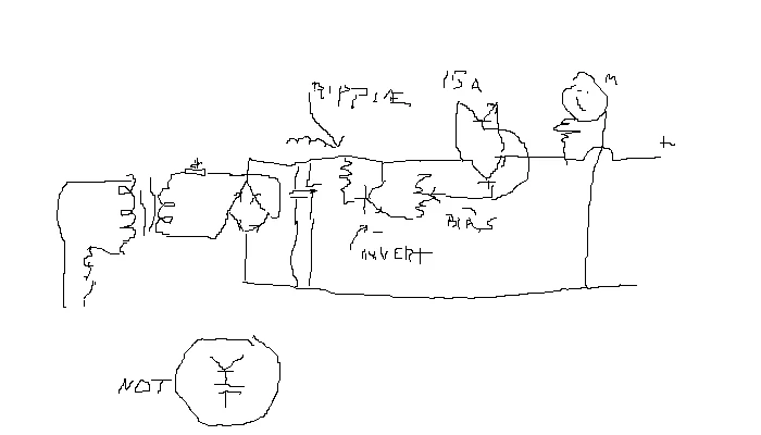

It will probably just sample the line ripple and amplify it and invert it through a dropping resistor on its collector. Just a standard circuit. I wish I could find a better way of doing it since the ripple invert has to follow a variable output. Thanks.

Patch Cabbage said:I'm setting up an analog power supply. I have the transformer bridge and filter capacitors so far. The transformer puts out 30 volts. I am currently using two parallel power transistors and a variable resistor to set the output. It also has a meter to monitor voltage. The question is this. How do I set up a single transistor to remove whats left of the ripple after the filter capacitors. It has to vary along with the control transistors to be constant in its ripple removing. The bases of the two power transistors to the potentiometer is currently the control.

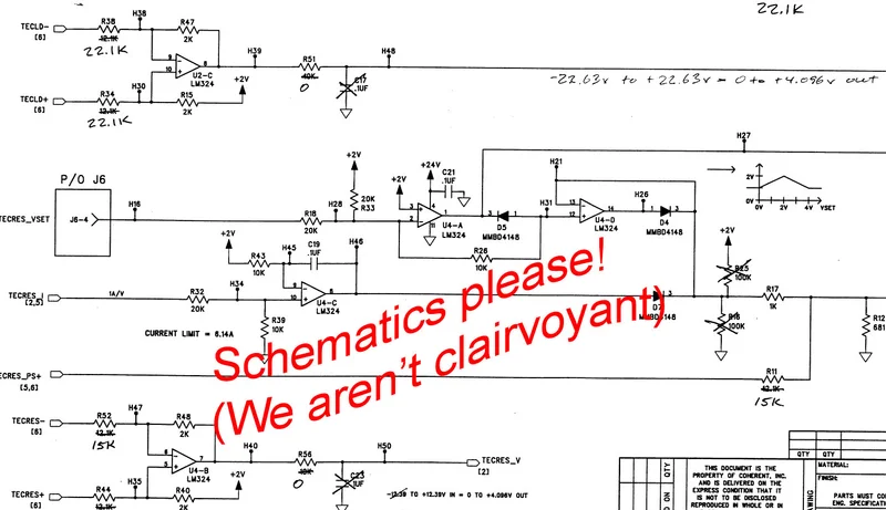

Well, it's the old GIGO principle I guess. But maybe we can still help you a bit, since this part of your circuit makes no sense to me:Patch Cabbage said:No problamo, as I have learned nothing from this thread.
The two transistors are not connected as any kind of voltage regulator. Their only function that I can see is to convert current into heat, and lower the efficiency of your unregulated power supply. Did you mean to describe some other connection of these transistors?

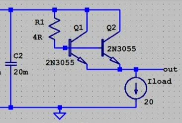

He seems to have connected the transistors as diodes. Just a more expensive solution.berkeman said:this part of your circuit makes no sense to me:

I drew the diagram that way, as it fitted the written description. That forms a current regulator, as the resistor current is multiplied by beta, then passed to the output, and through the load.sophiecentaur said:He seems to have connected the transistors as diodes.

A regulator has a reference. What reference is in that circuit. (I realise that things can be hidden or inferred)Baluncore said:That forms a current regulator,

The resistor is selected by the operator to adjust the load current, and so the output voltage. However, the "ripple inverter transistor" wherever whatever is not shown.sophiecentaur said:What reference is in that circuit.

OK. I was looking for a voltage regulator - which is normally what one wants.

But then what regulates the resistor current? If the voltage applied changes, so does the current. Just semantics, I guess. It works more like a resistor, as you described. More like a current limiter.Baluncore said:That forms a current regulator, as the resistor current is multiplied by beta, then passed to the output, and through the load.

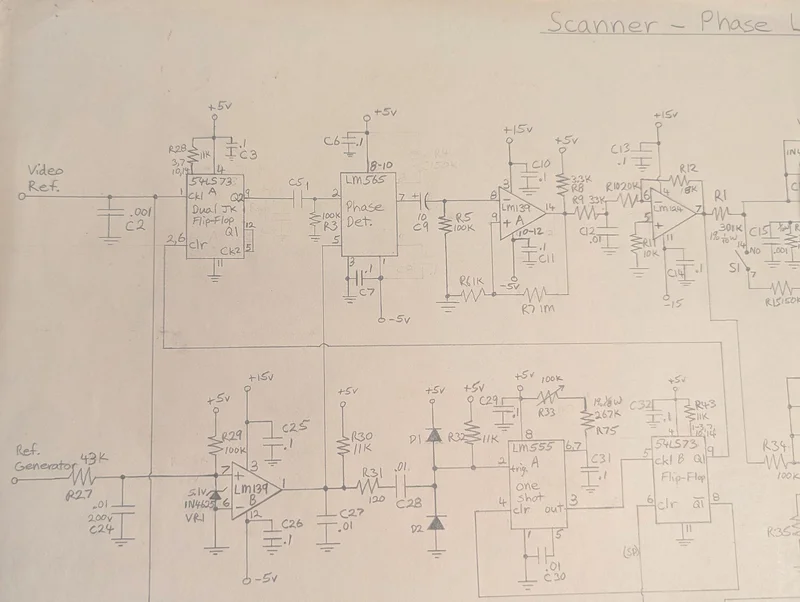

This is one of my first real designs for money as an EE. It was drawn by hand (early 1980's) and is a #$@! sight clearer than your attempt. The reason you don't draw readable schematics is probably that you don't care enough about communication with other engineers to put in the effort required.Patch Cabbage said:I'm not proficient in daw and I draw still with a pen and paper and not a mouse so sorry about all the sloppy schematics.
This is a quick schematic sketch I drew by hand about 40 years later.

I don't really care much about your "first thought response" at this point. You aren't putting in the effort necessary to make progress here. These words don't mean anything to me. You need to study more. This is the only useful advice I can give at this point.Patch Cabbage said:My first thought response would be that the variable resistor is really big, but that leads to the ripple invert is biased to be slightly on all the time. Not for sure if it will ever go down to zero. It should but it might not. Also the ripple invert is fixed and the voltage output is variable so that's not so perfect either.
