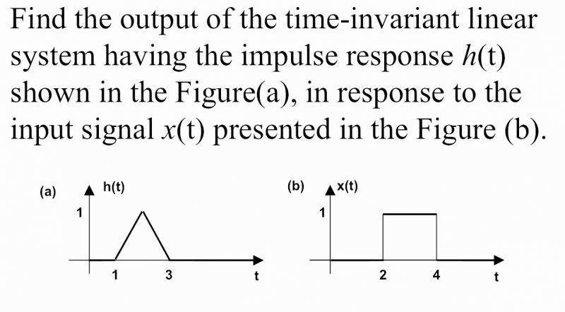

The question is in the attached image . My problem starts when dealing with the limits of integration . I need an analytic procedure of solving such problems without involving graphical method . The equations of the graphs of h(t) and x(t) are easily derived .

h(t) is non-zero for 1<t<3, so your integral will be zero for t<3, it will grow on 3<t<5, then shrink down again on 5<t<7 and be zero from that point on.
So from the outset, restrict t to between 3 and 7 and see where that gets you.

##f(t) = \int_{t-4}^{t-2} h(\tau) d\tau = \int_{2}^{4} h(t-\tau) d\tau##
If the intersection: ##[t-4, t-2] \cap [1,3] ## is empty, then the function is zero, since the integrand is zero over the entire integral.
This intersection is maximized when the two ranges match exactly, i.e. t=5.
Other than that, you are evaluating a portion of the area under the tent of h.
