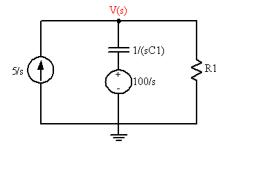

Now for part d I'll tell you what I did. I know that 5u(t) = CdV(t)/dt + V(t)/R is true because of the current law. After taking the Laplace and dividing by C I get 5/Cs = sV(s) - 100 + V(s)/R. Solving for V(s) I got V(s) = (5/C)(1/s(s+1/RC)) + 100/(s+1/RC). The second term will just become 100e^-t/RC. For the first term I just multiplied (1/RC)/(1/RC), and then I took the inverse and I got it to be 5R(1-e^-t/RC). So V(t) = 5R(1-e^-t/RC) + 100e^-t/RC. So I guess this might be right or wrong (not sure honestly), but my problem is that I don't know how to use this to write an expression purely in terms of R, and then use the information in part e to find the unknown R value.
Do you know where I should go from here, or what concept I should employ? I think the method you proposed is interesting, I think I remember seeing something like that from when I took an earlier circuits class, but I am not sure. Could you show me what you're talking about, if that would help? Thanks a lot.

In the Laplace domain the capacitor has impedance 1/(sC). A capacitor with an initial voltage can be modeled as an uncharged capacitor of the same value in series with a voltage source of the same value as that initial voltage. Your equivalent circuit becomes:
Write the node equation for V(s) and solve it for V(s). Then you'll have your Laplace form for the voltage, ready to take the inverse transform to find v(t).

...wow, that was much easier than I thought it would be. The answer was in front of me the whole time.
OK, so part c I think I'm understanding the difference. When I was subtracting before, that wasn't actually the voltage at that point in time, I think.
For part d, yeah, I forgot the C. So I did what you said. I plugged in 150 for V(t), .2 for t, and 1.23 for RC, and I got R = 29.8 ohms (part e). That really makes sense to me now. RC is a constant. It doesn't change. That's what I need to take away from this.
I love the way you modeled that other circuit. I've never seen that before though, and I'm having trouble getting an equation that matches the other one I made. So following the current law, shouldn't the equation be 5/s + (100/s -V(s))sC1 = V(s)/R1? But this doesn't make any sense because this would give me a different time constant?

That's the idea, but I'm seeing a different value for R. When you equation is rearranged it can look something like:
##V(t) = 5 R + (100 - 5 R)e^{-t/\tau}##
Presumably that was where you started before plugging in your values? Maybe you can show more of your working for isolating R?
You should end up with the same results. Make sure you've got all the signs right for the KCL of the node equation. I usually find it easier to choose that all the currents are assumed to be leaving the node and write all the terms on the left and set the equation equal to zero. The math will then sort out the actual directions automagically.

Sorry about that gneill. I'm an idiot and so I forgot to distribute the 5R into the equation. After I did that I matched the equation you got. I got R = 49.9 ohms.
About the circuit you modeled, you're right, I got the same answer after doing it the way you suggested. It turns out that I messed up one of signs.

Yeah, I think I put something wrong into my calculator because I couldn't reproduce that answer. Anyways, e^(-.2/1.23) = .849, so the equation becomes 150 = 5R +(100-5R)(.849)
So 150 = 5R + 84.9 -4.245R, so 65.1 = .755R, so should R = 86.2 ohms?

Much better! I'm seeing 86.7926 to four decimal places, no rounding or truncating of intermediate values in the computation, so you can verify your calculations. It's a good idea to keep extra decimal places though all intermediate steps and only round the final result. This keeps rounding and truncation errors from growing into the significant digits.
