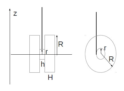

A yo-yo consists of two cylinders with radius ##R##, mass ##M## and height ##H## connected by a smaller cylinder of radius ##r##, mass ##m## and height ##h##.
Determine the yo-yo's acceleration in ##z##-direction, using its moment of inertia.
Moment of inertia of a solid cylinder: ##I=\frac12mr^2##
The yo-yo's total moment of inertia is ##I_{\text{tot}}=\frac12mr^2+MR^2##, using the formula for solid cylinders. However, I don't know how to proceed from here.
Free body diagram.
##\sum F = ma##.
##\sum \tau = I \alpha##.
Hi Cep,
Could gravitational acceleration appear somewhere ?
I guess so. The acceleration probably consists of both gravitational acceleration downwards and the acceleration upwards caused by the "user" of the yo-yo.
Is that what you mean?
Yes. Make a sketch where the driving force acts and how it results in a torque.
