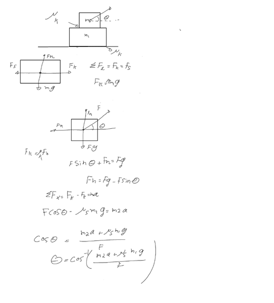

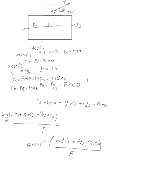

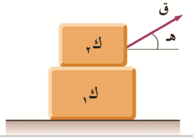

what is the angle the force should apply in order to be box number 1 in static position and box number 2 move
F=ma
Since all starts from rest, you only need to get mass 2 to start moving while mass 1 stays still. That means you only need to overcome static friction on the one and not on the other. Kinetic friction does not enter into the equations at all.rashida564 said:![]()
