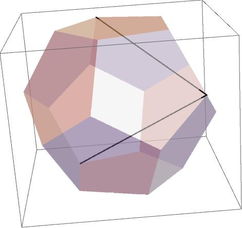

How about angles in any regular polyhedron? Any magic numbers there? Would make for an interesting problem I think: Find a polynomial for which a root is a magic number of a dodecahedron.

It looks like you can use a Rhombic Dodecahedron. It would have an inner long axis that aligns with the Earth axis.
