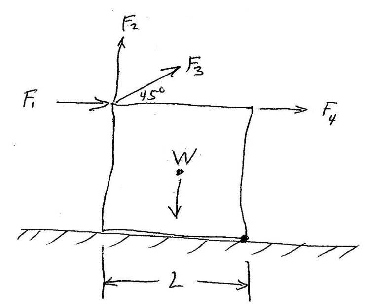

Not so much a formula, as a calculation procedure. Assume the crudely sketched block in the figure below is on level ground, has a weight ##W##, and that you apply the tipping force as ##F_1##, ##F_2##, ##F_3##, or ##F_4##. We solve these problems by taking a sum of moments. A moment is a force multiplied by a distance. The weight of the block ##W## is a force straight down, and that force is through the center of the block. You can apply your tipping force by pushing horizontally at a corner, pushing vertically at a corner, pushing at an angle at a corner, or pulling on a corner.
Assume the (perfect cube) block has length / width / height ##L##, and the tipping point is the lower right corner. We take our moments about the tipping point. The moment due to the weight ##W## is the weight times the perpendicular distance from that force to the tipping point. That distance is ##L/2##, so the moment is ##W * L / 2##, or ##WL/2##. Similarly, the moments due to tipping forces ##F_1##, ##F_2##, or ##F_4## is ##F_1L##, ##F_2L##, or ##F_4L##. When the tipping moment is equal to the moment due to the weight of the block, it tips. The formula is ##F_1L = WL/2##, which we solve for the force ##F## and get ##F = W/2##.
The force ##F_3## is at a 45 degree angle, so the perpendicular distance is ##1.414 * L##, and the tipping force is ##F_3 = 0.35L##. And you are correct, when the block is at 45 degrees, it will be balanced. Sandstone weighs 100 to 170 lbs per cubic foot depending on porosity and water content if you want to estimate the weight of your blocks.

p.s. I notice your sketch seems to have the first force applied at the top at 45 degrees. This is not what I was/am thinking of. I imagine a first force as applied upwards from the bottom corner. That's why I started by saying let there be a 10 degree angle so's you can get your fingers in there. Not needed, I know, for mathematical problems etc - but just making it 'real'.
If I were trying to roll a cube of decent size with maximum effect, I'd get finger tips below to anchor and also push with my chest. There would be two forces applied. Or one net force plus a net torque if you wanted to decompose things that way.

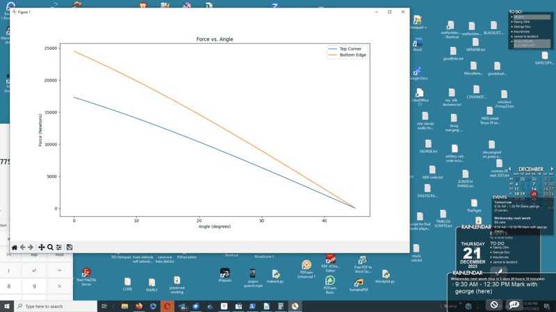

abrogard said:
...we can assume that forces will always be applied in the 'best' direction...the forces required at any particular angle. ....
For cubes of uniform density and force applied in optimal direction at the bottom edge opposite to pivot edge (or the edge above the pivot edge):
F = m*g*cos(alpha + pi/4) / sqrt(2)
Force applied in optimal direction at the edge diagonally opposite to pivot edge :
F = m*g*cos(alpha + pi/4) / 2
where alpha is the tilt angle in radians.
Thanks again for that. I got a routine up and finished up with a line graph of the results. I was surprised to find the top edge so far in front.
The diagonal of a square is sqrt(2) times longer than its side, so the force with diagonal lever arm is 1/sqrt(2) times the force with bottom lever arm.
