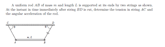

Angular Acceleration of a Rod in an Uneven String Setup

Diagram of a uniform rod AB of mass m and length L hung by two strings, AC on the left and BD on the right, with angles of theta measured from the ceiling at each string.
Note : In the above setup the string lengths are unequal and the left angle is 30° and right angle is 60° .
[/B]
Just after the string is cut , writing force eq. for rod in vertical direction .
##Mg - Tcos60° = Ma_y ## (1)
Writing force eq in horizontal direction
##Tsin60° = Ma_x## (2)
Writing torque eq about the CM of the rod ,
##Tcos 60°\frac{L}{2} = \frac{ML^2}{12} \alpha ## (3)Writing constraint eq. for the left end point of the rod where string is attached ,the component of acceleration of left end along the string length should be zero .
##a_ycos60° - \frac{αL}{2}cos60° - a_xcos30°= 0 ## (4)Solving the above four eqs .give ##T= \frac{2}{7}Mg##
and ##\alpha = \frac{6g}{7L}##
Could someone check my work ?
  • Physics diagram of a uniform rod AB of mass m and length L hanging horizontally from two strings AC and BD, which meet a ceiling at C and D; angles of 30 and 60 degrees are marked at the strings.
According to official answer key , T=Mg/2 and α = 3g/2L :oldeyes: .
Do you mind rechecking the constraint equation ?
Is there some sign error ?

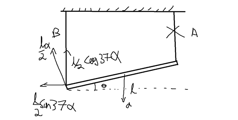

Thanks @haruspex
Please see the attached image .
Just after the right string is cut , the net acceleration of the CM of the rod is vertically downwards .Hence rod must move such that CM falls straight down.The left end must also fall straight down .
But net acceleration of the left end point will be towards left ,which means the next instant after right string snaps , it moves towards left .
Aren't the movement of CM and left end contradicting each other .
I am sure I am messing somewhere .
  • Diagram of a uniform rod hanging from two strings, with its left end at B on a vertical string and its right end at A on a second string attached to a ceiling; the rod is tilted at angle theta, with labelled accelerations and components lα/2 and lα/2 cos37 and lα/2 sin37 marked, and a downward arrow for gravity acting at the centre of mass.
Why? There will be an angular acceleration.
Right . So the next instant , rod moves such that CM moves straight down and the left end moves leftwards ?
Yes.
