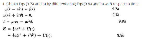

1. Obtain Eqs.(9.7a and b) by differentiating Eqs.(9.8a and b) with respect to time.
Aceleration in a polar coordinates and energy and momentum angular in a central force motion
Since the equations are, actually, the question, i will post the image with relevant equations here:

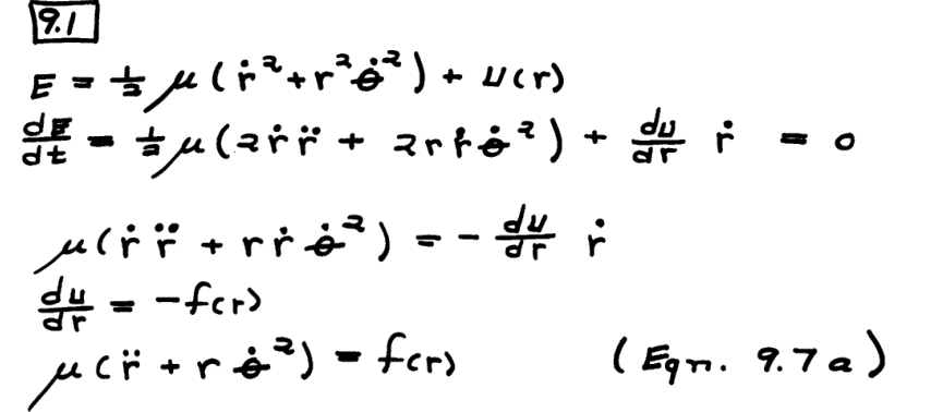

it seems strange, I'm almost sure that I didn't make a mistake in the differentiation, but differentiating 9.8b I found 9.7a with both positive terms
Did you remember to differentiate ##r^2\dot\theta^2## using the product rule?
Yes, will post soon.
[This solution is actually equal to my solution, which is, unfortunately, not equal to equation nine.seven a]
Assuming theta two dots equal zero.
Why would you assume that?

I did, just cutted the therm with theta two dots and so don't put in the resolution:
call theta by a
(r²a²')' = 2rr'a²' + 2r²a'a'', if a'' is zero, = 2rr'a²' like the image
But stopping to think now, i really see that [theta]'' is not zero, how to deal with that term?
Wow, using L = mw²r i got the answer! thank you
