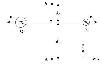

Two particles move in opposite directions along a straight line. Particle 1 of mass m1 = 23 kg at x1 = 16 m moves with a speed v1 = 34 m/s (to the right), while the particle 2 of mass m2 = 64 kg at x2 = −25 m moves with a speed v2 = −43 m/s (to the left). Given: Counter-clockwise is the positive angular direction.
1)What is the total angular momentum of the system about the z-axis relative to point A along y-axis if d1 = 13 m? Answer in units of kgm2/s.
2) What is the total angular momentum of the system about the z-axis relative to point B along y-axis if d2 = 22 m? Answer in units of kgm2/s.

L = Position [tex]\times[/tex] m v
I got number 1 correct, and number 2 should be the same. however just changing d1 to d2 does not give the correct answer.
1)
{16, 0 , 0} + {0, -13, 0} = {16, -13, 0}
{-25 , 0, 0}+ {0, -13, 0} = {-25, -13, 0}
{16, -13, 0} [tex]\times[/tex] (23 {34 , 0 , 0 }) +
{-25, -13, 0} [tex]\times[/tex] (64 {-43 , 0 , 0 }) = {0, 0, -25610} = 25610 k
2) should be the same but I get {0, 0, 43340} which is incorrect

Looks ok to me (opposite sign to 1), of course). :confused:
(btw, you could have omitted the {16, 0 , 0} and {-25, 0 , 0} :wink:)
hmm … you could try 43440, in case someone hit the wrong key. :redface:
Thanks the problem was that number 2 have to be negative.
