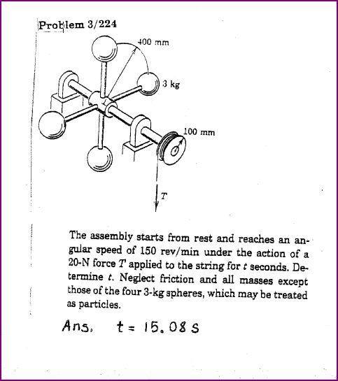

Ive been trying to figure this problem for a while and I am stumped, If anyone has any ideas
Id really appreciate it - The problem deals with conservation of angular momentum
and the answer is provided but I don't know how to get there
please see the attached image of the problem>>
Thanks :approve:
  • Problem 3/224: diagram of a rotating assembly with four 3 kg spheres on rods at 400 mm radius, a 100 mm pulley with string and 20-N force T, and handwritten answer t = 15.08 s.

Hi blue-steel,
I don't think that is right; this problem deals not with the conservation of angular momentum, but with the change in angular momentum. What formula gives you the change in angular momentum of a system?
Once you have that formula, you can almost just plug in the numbers to get your answer. What do you get?
Hi alphaphysicist
I tried the Sum of all moments = change in angular momentum formula, it took me a while to figure out how to work with the cross products but I got the answer in the end, thanks :wink:
