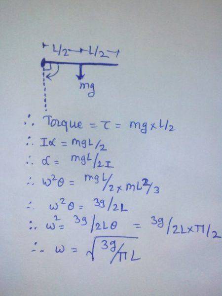

A uniform rod of length L & mass m is suspended through an end. It is shifted through an angle of π/2 radian i.e. made horizontal and then released. Find angular velocity when rod is vertical.[/B]
My attempt to a problem is attached
with this post.
But
Solution says
By energy conservation law
1/2 I ω2= mg L/2
(ω = angular velocity)
Hence
ω=√ (3g/L)
Which one is correct? N why other is wrong?[/B]
but in your soln you have assumed that torque remains constant throughout which is wrong
You must correct it and integerate to get the right answer
Likes Prathamesh and Sahil Dhull
Nope...i ve found the torque acting on the rod when it is in hzt position only... and hence angular acceleration (alpha) also changes with theta...so by putting theta =π/2 i ve found w
