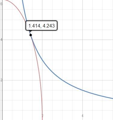

Hello, I have one more (hopefully last) question regarding implicit functions:
The ellipse
\[9x^{2}+y^{2}=36\]
and the hyperbole
\[xy=a\]
tangent at a point in the first quarter.
I need to find the tangent point and a.
thanks !

A precalculus technique would be to solve the hyperbola for $y$ and then substitute into the ellipse to get in standard form:
$$9x^4-36x^2+a^2=0$$
For the two curves to be tangent, we require the discriminant to be zero:
$$36^2-4\cdot9\cdot a^2=0$$
$$a^2=36$$
Since a tangent point is to be in the first quadrant, we take the positive root:
$$a=6$$
Hence, we have:
$$9x^4-36x^2+36=0$$
$$x^4-4x^2+4=0$$
$$\left(x^2-2\right)^2=0$$
Taking the positive root:
$$x=\sqrt{2}\implies y=\frac{6}{\sqrt{2}}=3\sqrt{2}$$
And so the point of tangency is:
$$\left(\sqrt{2},3\sqrt{2}\right)$$
