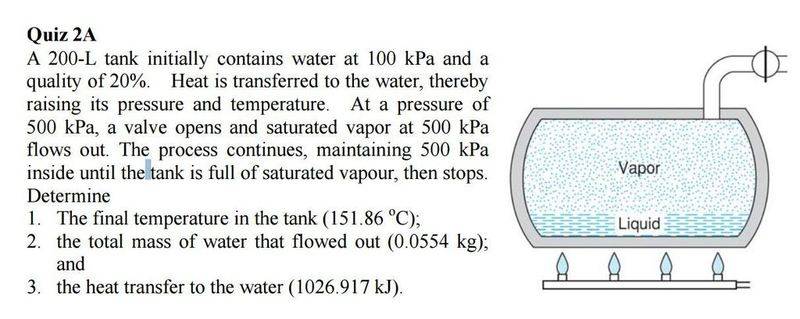

Start part 2 by determining the initial mass of water in the tank. (I assume you are using steam tables?).
Chet

DrVirz said:
Yes I am using steam tables. So the mass of the water at State 1 is simply Volume/Specific Volume... 0.04/0.001043= 38.351kg
Mass of the sat. vapor at state 1 is 0.16/1.694 = 0.0945
This is not quite right. Steam quality is defined in terms of mass fraction, not volume fraction. Please try again.
What I would then do is find the mass of the sat. vapor when the tank is full @ 500 kPa, i.e 0.2/37380 ... Then minus this from the summation of the above answers which would give the difference in mass in the tank at the 2 states? It is not correct though.
This is the correct approach.
I think I may be understanding the question wrong. I am assuming at state 2 there is ONLY sat vapor, no liquid?
This is correct. See the problem statement.

specific volume of the mixture ((0.2)0.001044+(0.8)(1.67185))=1.378 m^3/kg
Total Mass of water in tank = 0.2/1.378=0.1495 kg
Mass of liquid water in tank = 0.0299 kg
Mass of water vapor in tank = 0.1196 kg
Next step is to figure out the final mass of saturated water vapor remaining in the 200 liter tank at 500 kPa and 151.86 C.
Chet
Something is very wrong with this problem statement. You can see that at 100 kPa, the specific volume of the mixture is 1.378 m^3/kg. For saturated vapor, that specific volume occurs at about 105 C and about 1.3 Bars. This is that point at which all the liquid water would be totally evaporated. Beyond this point, the vapor would be superheated.
Chet
Oops. I made a mistake. Somehow I got it in my head that the quality was 80%, not 20%. When I use 20%, everything works out:
specific volume of the mixture ((0.8)0.001043+(0.2)(1.694))=0.3390 m^3/kg
Total Mass of water in tank = 0.2/0.3352=0.5900 kg
Mass of liquid water in tank = 0.472 kg
Mass of water vapor in tank = 0.118 kg
At 151.86 C and 5 Bars, the specific volume of steam = 0.375 m^3/kg
So, the final mass of saturated water vapor in the tank is 0.2/0.375=0.5333 kg
So, total mass of water that flowed out = 0.0567 kg (The difference between this value and the answer given in the problem statement must be due to the use of slightly different steam tables).
Now for the heat transfer to the water required to bring about this change. What is the form of the 1st law that applies to this open system situation?
Chet
