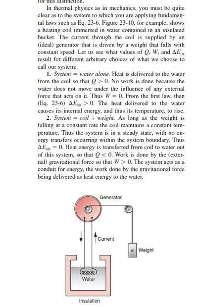

In Halliday's physics book, there is an example of the first law of thermodynamics that shows its application. The figure below explains this example:
Here is a question, if the element alone is chosen as the system, doubts arise in the first law, because in this system, Q<0 (because heat is transferred from the element to the water) and W=0 (because there is no external work on the system is not done) as a result the internal energy of the system (the element alone) should decrease while it does not because the temperature of the element is constant.!!!Part of the text:
There is external work done on the system (the resistor). The electrical work done is $$W=\int I(t)\ V(t) \ dt$$ Where ##I## is the current through the resistor and ##V## is the voltage across it.
For the combination of weight and coil, external work is done by gravity on the weight (by the earth), as the weight lowers. An approximately equal amount of heat is delivered from the coil to the water. The book author is a little wrong, because the coil gets a little hotter as the water gets a little hotter. But this increase in internal energy of the coil is negligible compared to the increase in internal energy of the water. The assumption is that the velocity of the weight does not increase significantly during the test, so that its kinetic energy doesn't need to be accounted for.
I thought that in the first law of thermodynamics, W external mechanical work is not necessarily mechanical work and can be electrical work and so on.
Yes, the expression I wrote is the expression for electrical work. It is not zero.

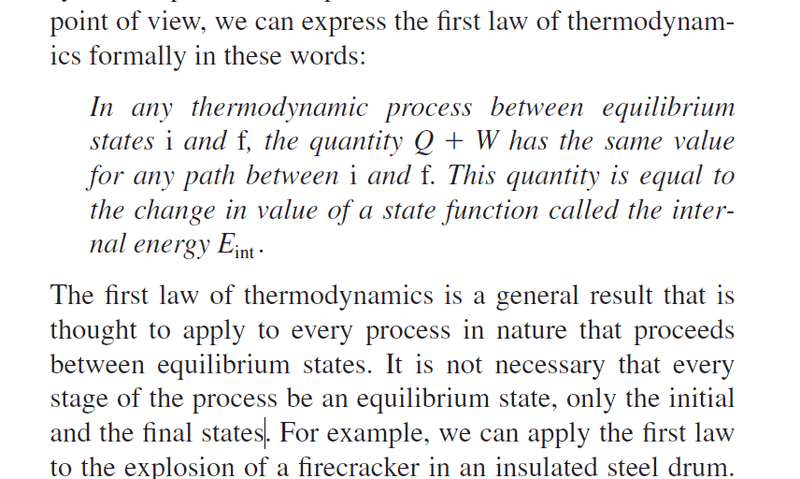

My second question is, if the initial and final state are not in equilibrium, then the first law of thermodynamics is not correct. Can you give an example?
An example is a gas within an insulated cylinder, featuring a massless frictionless piston above, where a weight is sitting on top of the piston, and part of the weight is suddenly removed; the gas expands rapidly and irreversibly. All intermediate states are not thermodynamic equilibrium states, and the first law of thermodynamics can not be used to determine the internal energy for these states. It can only be used for the final state in which the gas is again at thermodynamic equilibrium.

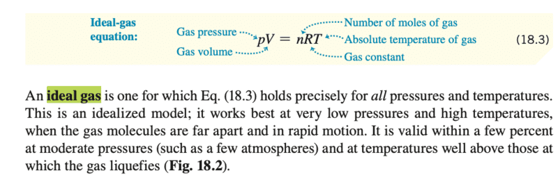

But doesn't "ideal" require an ideal gas: one that obeys PV=nRT over all ranges of temperature and pressure, with no viscosity?
No. An ideal gas is the limit of real gas behavior at low pressures (but not so low that the mean free path of the molecules is on the same order or larger than the physical dimensions of the system). Bird, et al. state "The chart (Fig. 1.3-1) shows that the viscosity of a gas approaches a limit (the low density limit) as the pressure becomes smaller; for most gases, this limit is nearly attained at 1 atm. pressure."
Because of viscosity, an ideal gas obeys PV=nRT only at thermodynamic equilibrium.

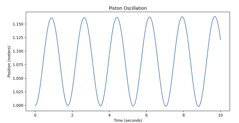

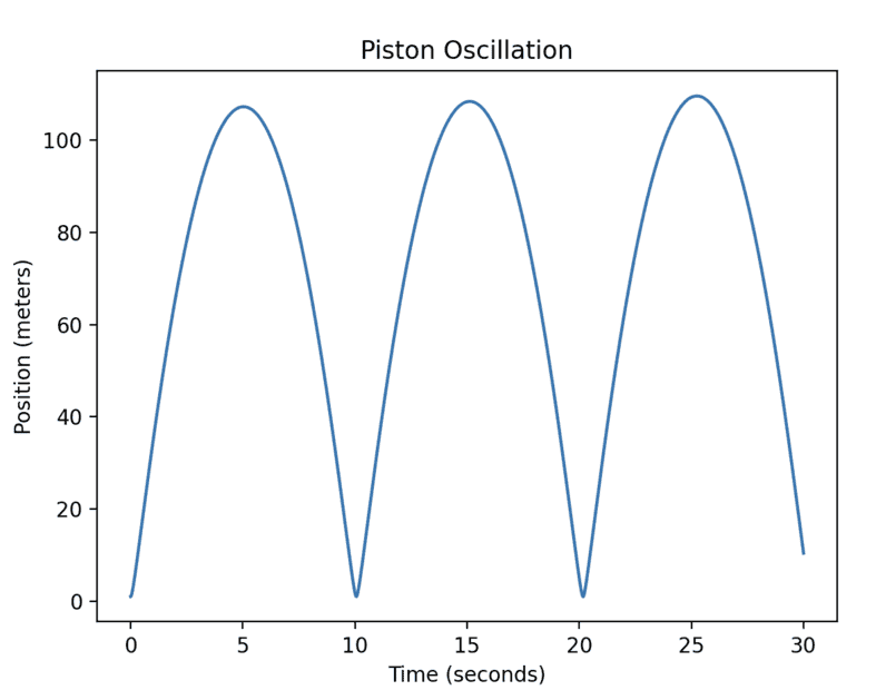

Just for giggles, I have simulated the example in python and have run it for an initial mass of 10 tonnes, removing 1 tonne :
Interesting things happen when most of the weight is removed. Here's removing 9,800 kg (all but 100 kg) and running the simulation for 30,000 iterations:
I think the process is reversible.
