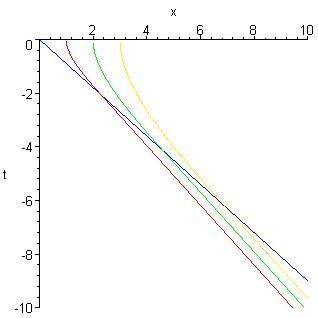

Let's go on to your example:
you write
We will specify the distance traveled in the frame of the twin on the space ship. The ship is towing a buoy behind on a rigid steel rod which is 10 light years long measured at rest. The ship leaves Earth at 0.866c and will turn around when the twin on Earth sees the buoy reach earth.
you can see from the attached diagram - or similar diagrams at
http://www.mathpages.com/home/kmath422/kmath422.htm
that the far end of the ship does NOT start deaccelerating "at the same time" as the near end of the ship in the Earth frame.
The far end of the ship and the near end of the ship start deacceelrating "at the same time" in the SHIP frame, but NOT the Earth frame.
The attached diagram shows a ship slowing down from .9c to rest at an accaeleration of 1 ly/y^2 (roughly 1g).
The diagram is drawn in the Earth frame of reference.
The three curves on the diagram represent three points on the Born-rigid body that represents the ship. Your example was 10 LY, the diagram I drew was for 3 points, each 1 light year from each other.
The straight blue line on the diagram denotes the instant at which each particle of the body starts deacelerating.
The important point to notice is that while the blue line (the start of deacceleration) appears to start at "the same time" in the frame of the moving body, it definitely does not appear to start at the same time in the Earth frame.

Eliminating the rigid rod would certainly simplify the discussion.
Basically, if you have a ship A that goes out, turns around, and comes back, the fact that a second ship B is following the first at some "constant distance" is going to be totally irrelevant to the proper time elapsed on A's clock. I'm not sure why this isn't totally obvious to you.
B can follow A, or B can not follow A - it won't affect A's clock one bit.
The important point is that in flat space-time (where SR is applicable) if A starts out at the same point as some inertial observer C, follows a path which is not inertial, then re-unites with C at some later date, A's clock will have less time on it than C's clock.
