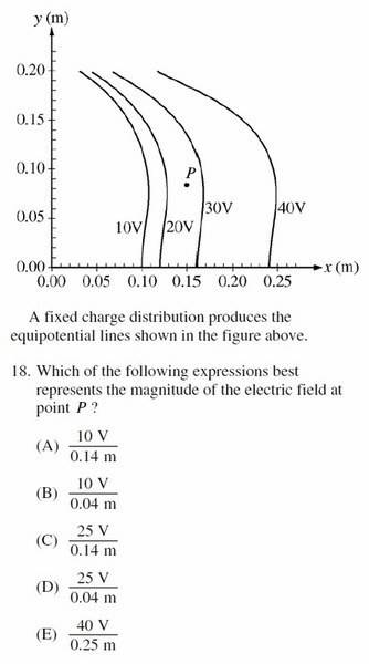

Quite confused for these problems. For number 18, I'm quite baffled as to where the 0.04 meters even comes from. What I had attempted to do was find the potential at the point, 25 V, and divide it by the radius, or √(.15^2+.08^2), but that didn't even yield one of the answers. Then I realized that the potential was actually increasing as x increased, and that the object causing the electric field was likely off the graph. Then I just got really confused.

[ IMG]http://imageshack.us/a/img405/2379/182008.jpg[/QUOTE]

What radius are you referring to ?
How far are the 30V and 20V equi-potential lines apart in the vicinity of point P ?

Oops, I'll make sure to spread the problems apart more next time. I understand number 18 now. E=-dV/dr, so the strength of the electric field is the change in voltage/change in distance. So since the equipotential lines for 20 and 30 V are .04 m apart, it would be a change of 10 V/a change of .04 m, so B.
