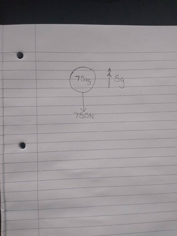

Have you drawn a free body diagram of the astronaut showing the forces acting on him, or do you think you have advanced beyond the need to do that?
I drew a free body diagram but I'm not sure if I did it correctly
Let’s see it and the associated force balance equation.
I'm not sure what you mean by force balance equation
But here is a rough free body diagram
That clearly shows a downward force and an upward acceleration!
However, perhaps the real question in this case is what is weight anyway?
I don’t see a. gravitational force acting on him, and I don’t see an upward force from the seat he is in.

In this case I would take apparent weight to be the force between the astronaut and the seat she is sitting in.
F-mg = ma

I've figured out how to do the FBD's and I think I've got it now, thanks for the help and sorry for being a bit thick
##F-mg=ma##
##F=mg+ma##
##F=m(g+a)##
##F=75(10+50)=4500N##

Yes, but you did not need to assume a value for g.
If the upward acceleration is 5g then the apparent weight is 6 times the rest weight.
