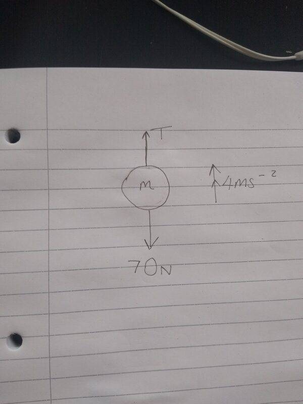

Let’s see your fbd.
Chestermiller said:
Let’s see your fbd.
I am not sure if I've added all the forces I need
Gravity? Isn't ##T = 70N##?

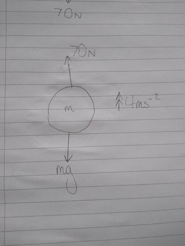

The question tells you that the spring balance reads ##70N##. That means that ##T = 70N## in your diagram.
Is this more accurate?
That looks better. What does ##a = 4m/s^2## tell you?
That I have a vertical acceleration of 4m/s^2?
Yes, okay, but more than that. Hint: Newton's 2nd Law.

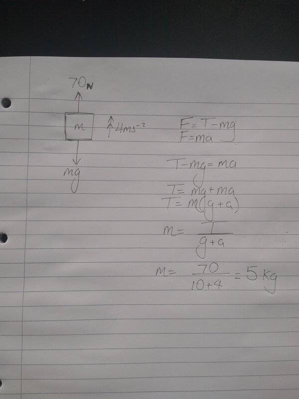

The ##F## in Newton's law is the unbalanced force, which is the vector sum of all forces on the body. In this case we have:
$$F = T - mg, \ \ \text{and} \ \ F = ma$$
Where, to be precise, I have taken upwards as the positive dircetion.
PeroK said:
The F in Newton's law is the unbalanced force, which is the vector sum of all forces on the body. In this case we have:
F=T−mg, and F=ma
Ahhh I see
Sorry for taking so long to get there! I appreciate the help
