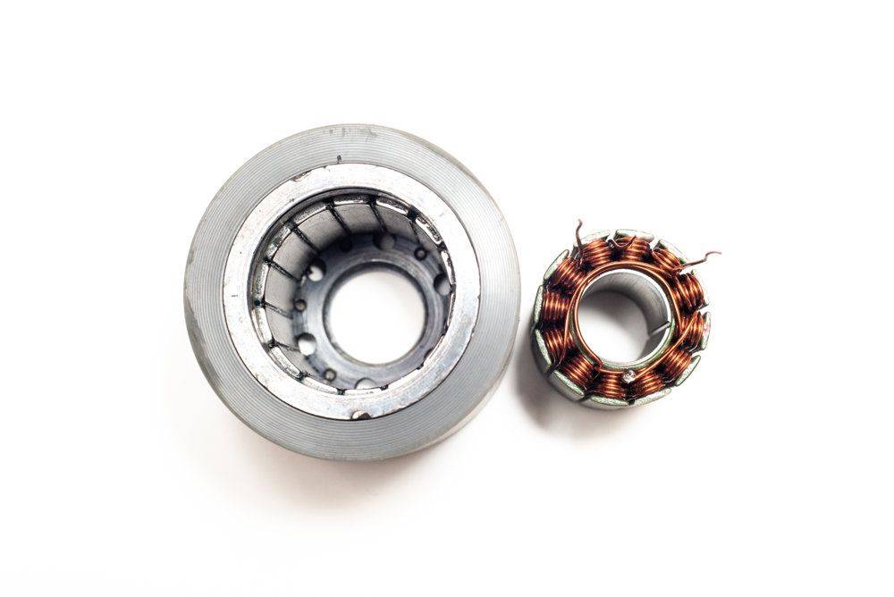

tzonehunter said:
"An emf is induced in the coil..."
or
"An emf is induced across the coil..."
I thought perhaps this would be a useful illustration here... a photo I took of the innards of an electric skateboard hub motor (84mm tire diameter) with exposed stator core consisting of 12 wound coils/solenoids...
Photo of two parts of an electric skateboard hub motor on a white background: a larger steel rotor ring with internal magnet slots on the left, and a smaller stator core with copper coil windings on the right.
