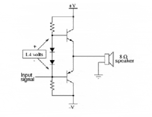

If you want to play around with transistors you can build a class AB amplifier:
Circuit schematic of a class AB push-pull transistor output stage with +V and -V supply rails, two diodes labelled 1.4 volts biasing the bases, an input signal node, and an 8 Ω speaker at the output.

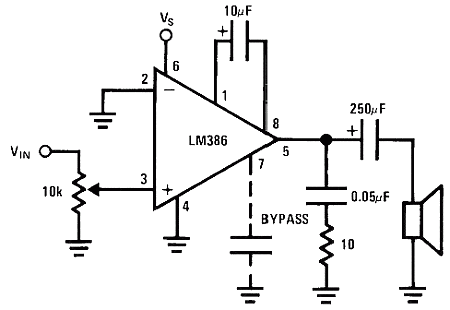

or you could build a simple amplifier with a chip LM386:
Circuit schematic of an LM386 audio amplifier with a 10k potentiometer at the VIN input, a 10 µF capacitor across pins 1 and 8, a bypass capacitor on pin 7, and a 250 µF output capacitor feeding a speaker through a 0.05 µF and 10 ohm Zobel network.

What transistor? NPN or PNP?
what's first circuit contains one of each, right?
Ya ! Which transistor? And how to adjust the base? And second circuit, what is mean by "by pass"?
I don't think this forum is the place to be looking for advice and circuits to build when a person can't tell the difference between an NPN and a PNP transistor from looking at the schematic. There are several other things omitted from the schematic that what posted as well. Not that it isn't a workable circuit, but it is not a turnkey solution. It is a place to start.

I agree with supernova -- you are not ready to make an audio amplifier from scratch.
But, you may be ready and interested in building an audio amplifier kit. That's a great way to learn how to build electronic circuits, and each kit generally comes with tutorial materials to help you understand how it works.

Not me can't see the difference but have PNP and NPN transitor in first diagram and I just learn basic electronic only!
