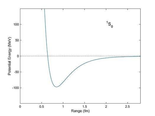

Now consider where 2000 fm would be on that scale.
