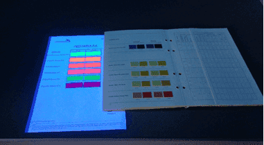

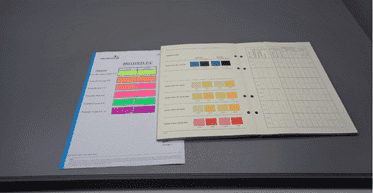

Just to add from the guys above
Sometimes better with a few illustrations
Fluorescent / high vis clothing looks bright in day light because day light has a UV content that activates the dyes/pigments
A light box below with dye/pigment samples. The light source is D65- artificial daylight so there will be UV content in there
Pigments on the left, dyes on the right, left is fluorescent right is "normal" dyes
Switch the light source UV only which is barely visible to human eye and only the fluorescent pigments are visible.
Also notice there is some fluorescence on the paper on the left?
You can add an FWA/OBA (fluorescent whitening agent or an Optical brightening agent) to paper pulp- it gives it a bluish whiteness.
Similar thing in washing powder for whites.
