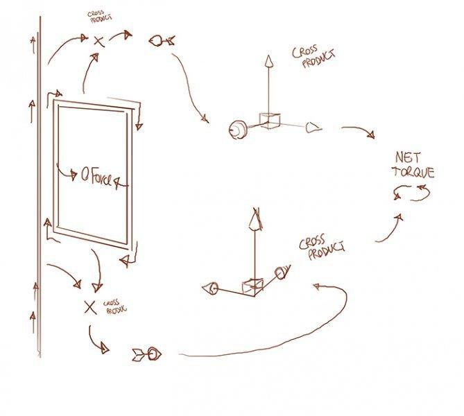

Let's simplify things. Let's say that you have a uniform B field pointing upwards, and you have a square-shaped loop of wire oriented like a window or a door. Let's say that the current on the loop is going clockwise, so on the top the current is going to the right, on the right the current is going down, on the bottom the current is going to the left, and on the left the current is going up. So, the second equation says that the force is ##f=J \times B##. For the currents on the side, going up and down, those are parallel to the upwards B field, so those have 0 force. For the top, the current to the right crossed with the upwards field gives a force towards you. For the bottom, the current to the left crossed with the upwards field gives a force away from you. The two opposing forces give a net torque, which tends to rotate the loop.
That is the basic idea why the magnet rotates. There are some slight complications in the scenario you asked about since the B field is not uniform and the current loops are bound currents instead of free currents, but the principle is the same and the complications just make the description more cumbersome without adding any insight.
So, this is what I understand of your epxlanation
Wow. Nice drawing! Looks right on.

Still I´m a little confuse about some other things about what you say, I have to examine all that a little closer.

lennon said:
In other words, as much as I see it -and maybe I´m very wrong about this-, your explanation gives a good account of why there is a torque (i.e. to opossite forces in the same plane), but doesn´t explain why this torque goes in one direction and not the other (since the direction of the resultant of the cross product is -as far as I see- a convention).
The explanation explains both the torque and also the direction of the torque.
The coordinates/basis are a convention that doesn't change anything. The other important conventions are the sign of the charge on an electron, and the handedness of the cross product. Those two conventions would change the direction of J and B respectively, but they would not change the direction of the force.
