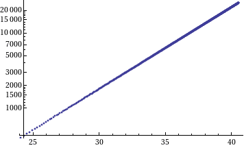

That's not true, since the exponential function \exp(z) is periodic in the complex plane with a period 2 \pi i. Within one period (a band with sides parallel to the real axis and width 2\pi), the modulus of this function takes all positivie values (as the real part goes from -\infty to \infty). The function z^4 has an unbounded modulus, and it winds the phase four times, so it will have many (I am thinking four) intersections in each band. That's infinitely many intersections.
Here is a semilog plot of {Re[x],-Im[x]} (I had to use the minus sign since all the imaginary values turn out to be negative) of the first 1001 complex roots to that equation:
