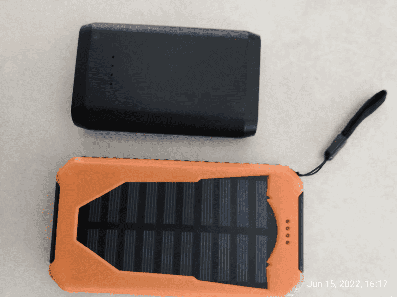

I have two portable USB battery chargers. They are different brands. See the picture.
Both of them charge a cell phone fine, but they won't charge my hearing aids in the aids charger. When I plug them in, they charge for 10-15 seconds, then shut off. Both devices do approximately the same.
It occurs to me that those devices may have circuitry to detect if a load is plugged in. If not, they shut themselves down. I have a theory that the hearing aids current draw is so low that the device thinks "no load at all."
Might I be correct on that theory? or is there a better theory?

Maybe and probably, but there are many possible theories.
Put a resistive load, with a volt meter, across the charger.
Find the resistive load needed to keep the charger operating.
That should answer your question, or refine the search.
Yes, its happened to me. Try charging your hearing aids as you charge your phone with the same battery. It should work fine as the circuitry sees enough current being drawn.

Seems you are correct. We have the same issue with our 27000 mAh power bank. It charges phones fine, but if we connect our digital blood pressure monitor or handheld nebulizer machine to it, it shuts down after some time. In fact, even what @jedishrfu suggested above doesn't work for this one, which probably implies that it can control the ports independently of each other.
