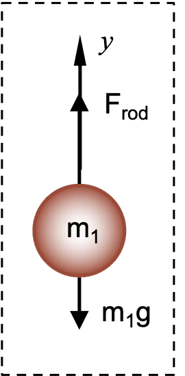

View attachment 3516191. Identify the system and draw it.
The system is the mass ##m_1=3~## kg at the bottom of the trajectory.
2. Identify all the pieces of the Universe that interact with the system and count them.
The pieces that interact with ##m_1## are the Earth that attracts it and the rod that is attached to it. This makes a total of two pieces.

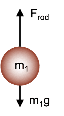

View attachment 3516213. Draw one and only one arrow representing the force exerted by each of the items in (2). Label each arrow unambiguously.
See figure on right. The Earth exerts force ##m_1g## that is always down. The force exerted from the rod must be in a direction along the rod, i.e. vertical. It cannot be up because if it were, the mass will accelerate vertically down and not go around in a circle.
4. Choose a convenient coordinate system and draw it. Enclose your system, axes and forces in a View attachment 351623box with dotted lines.
Positive direction is up as indicated by the arrow labeled ##y##.

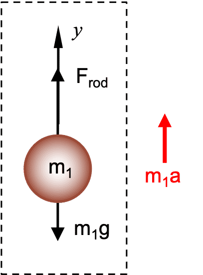

View attachment 3516245. Declare the acceleration. Draw an arrow outside the box indicating the direction of the acceleration. If you have chosen the coordinate axes wisely, the acceleration will be along one of the principal axes (x or y). Label the arrow "m"a, where "m" is the symbol you used for the mass in (1).
Mass ##m_1## is going around in a circle. Since all the force vectors in the diagram are along the vertical, the acceleration can only be along the vertical, up or down. Now the mass is going around in a circle centered directly above ##m_1##. The acceleration is centripetal (towards the center), hence its direction is up.
6. Add all the forces vectorially to obtain the net force, the left side in Newton's second law. Check that the vector sum of the arrows inside the dotted line gives a resultant vector in the direction of the "mass times acceleration" vector that you drew outside the dotted line in (5).
Anything up is positive and anything down is negative, so $$F_{\text{net}}=F_{\text{rod}}-m_1g.$$7. Set the net force vector equal to the mass times acceleration vector outside the FBD. Solve for what you are asked to find.
$$F_{\text{net}}=F_{\text{rod}}-m_1g=m_1a$$ Since the acceleration is centripetal, $$F_{\text{rod}}-m_1g=m_1v^2/(L/2).$$ You have the speed ##v## from a previous part, you need to solve the force exerted by the rod on the mass. The force exerted by the mass on the rod has the same magnitude and opposite direction to that.

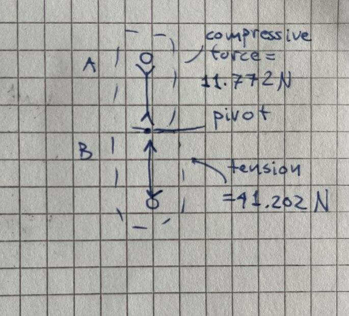

Thank you so much! That is a very nice guide. Using this I get that T_1 = m_1*(2*v^2/L-g)= -11.78 N (down), G_1 = m_1*g = -19.62 N (down), T_2 = m_2*(2*v^2/L+g) = 41.19 N, G_2 = m_2*g = -29.43 N. Do you agree with this?

Thank you so much! That is a very nice guide. Using your tips I get that T_1 = m_1*(2*v^2/L-g)= -11.78 N (down), G_1 = m_1*g = -19.62 N (down), T_2 = m_2*(2*v^2/L+g) = 41.19 N, G_2 = m_2*g = -29.43 N. Do you agree with this?
  • #33
Yes, ##T_1 = -11.78 N##, but remember that we are taking towards the axis as positive. So which way is a force of -11.78N acting?
  • #34
I get that, but that disagrees with my free-body diagram. Is T_1 really upwards? Do you agree with the other directions though?

Thank you for the examples! I am not sure if I understand them correctly though. Trying to solve them I get:
Q1: a) 5 N down, b) 5 N (equal in magnitude to a), c) 5 N up (opposite to a)
Q2: a) 3 N up, b) 3 N, c) 3 N down
Q3: a) 25 N up, b) 25 N, c) 25 N down
Q4: a) 17 N up, b) 17 N, c) 17 N down
Based on this I would guess that the force on the axis is then sqrt(T_1^2 + T_2^2) = sqrt(11.78^2 + 41.18^2) ≈ 42.84 N downwards. What do you think of this?

Hm okay, do you mean that the force on the axis will be the resultant force of the radial forces and the vertical forces, where the radial forces are the centrifugal forces (m_1+m_1)*v^2/r and the vertical forces are the gravitational forces?
Then I would get this:
(m_1+m_2)*g => sqrt((m_1+m_1)*v^2/r)^2+((m_1+m_1)*g)
=> sqrt((2+3)*1.4^2/0.5)^2+((2+3)*9.81)^2) ≈ 52.82 N

I get that, but in my case I thought the only forces working are the radial forces and the vertical forces, where the radial forces are the centrifugal forces (m_1+m_1)*v^2/r and the vertical forces are the gravitational forces?
This would result in:
(m_1+m_2)*g => sqrt((m_1+m_1)*v^2/r)^2+((m_1+m_1)*g) at angle tan^-1(((m_1+m_2)*g)/((m_1+m_1)*v^2/r))
=> sqrt((2+3)*1.4^2/0.5)^2+((2+3)*9.81)^2) ≈ 52.82 N at angle theta ≈ 68.22 degrees
What do you think of this then?

You need to add the two forces on the pivot. What are the magnitude and direction of each force on the pivot?
I find this very difficult to get my head around, so thank you a lot for your help. On the pivot I only really find T_1 = 11.78 N upwards and T_2 = 41.18 N upwards. Aren't these kind of "on top of each other" when the rod is vertical? I think this seems very odd though.
  • #48
Your values are OK although I get 11.772N and 41.202N using a spreadsheet, so it seems you have introduced rounding errors at some point(s). But one (or both) of the direction(s) is (are) wrong.
Call the upper half of the rod A; this part connects the pivot to ##m_1##.
Call the lower half of the rod B; this part connects the pivot to ##m_2##.
You need to treat A and B as if they are separate rods connected to the same pivot.
What is the force (size and direction) exerted by A on the pivot?
What is the force (size and direction) exerted by B on the pivot?
(These questions are just like Q1-Q4 in Post #40 - which you correctly answered).
The total force on the pivot is then the sum of these 2 forces.

I mean, obviously the sum of the forces must be towards the center of the "circle", which would mean that the total force by A would be downwards and the force by B would be upwards. Do you mean that the total force on the pivot and on the axis is 41.2 N - 11.8 N ≈ 29.4 N upwards (rounded) ?
If so, what are your thoughts on the directions on the forces in the rod then? I thought this would be T_1 ≈ 11.8 N up, G_1 ≈ 19.6 N down, T_2 ≈ 41.2 N up and G_2 ≈ 29.4 N down.
  • #50
No. The pivot IS the centre of the circle. The direction of the total force on the pivot can't be towards itself; that wouldn't make sense.
The centripetal force on a object is always towards the centre of the circular motion. But the force on the pivot is not the centripetal force. Please try these questions (similar to the Post #40 questions):

Okay, so I think I get your point, and I think part of my problem is simply due to the language barrier (some physics terms can be quite difficult to translate). However I still struggle to see what’s wrong with my previous answers? Based on what you just wrote, I would think that the tensile force in Q1 is the force from the rod on the mass (pushing upwards), while in Q2 it is both the gravitational force and the force from the rod pulling down. Could you guide me on the right way? I feel like this is such a simple problem and I really want to understand it, but I must say I find it very difficult. Thank you for your help and patience!

Yes, Fair enough.
ymnoklan said:
However I still struggle to see what’s wrong with my previous answers? Based on what you just wrote, I would think that the tensile force in Q1 is the force from the rod on the mass (pushing upwards), while in Q2 it is both the gravitational fo N and rce and the force from the rod pulling down. Could you guide me on the right way? I feel like this is such a simple problem and I really want to understand it, but I must say I find it very difficult. Thank you for your help and patience!
Let’s call the section of rod between ##m_1## (at the top) and the pivot: ‘A’.
We know that the net force on ##m_1## is the centripetal force, 7.848N down. This force is the sum of:
a) ##m_1##'s weight, 19.62N down and
b) the force of A on ##m_1##, which is easily shown to be, 11.772N up.
Since the force of A on ##m_1## is 11.772N up, A must be in a compressed state; the compressive force is 11.772N.
(Alternatively, we could apply Newton's 3rd law and say that the force of ##m_1## on A is 11.772N down, compressing A.)
Since A is compressed (compressive force is 11.772N) it follows that the force of A on the pivot is 11.772N down. (A is like a compressed spring, pushing its ends outwards.)
The force exerted by the bottom half of the rod on the pivot can be found with similar logic. Then the two forces can be added.
The detailed working is best done using appropriate equations, but since it’s first necessary to have a conceptual understanding of what’s going on, I’ve keep the description fairly qualitative.

Is the force at the bottom downwards then (because B is in tension)?
Resulting in 41.19 N - 11.772 N = 29.418 N down.
  • #57
No.
The upper half of the rod is 'A'. The lower half is 'B'.
Yes, B is in tension - how did you deduce that?
Say, you have a vertical spring in tension, held stretched between a support at the top end and a support at the bottom end:
- what direction is the force of the spring on the top-support?
- what direction is the force of the spring on the bottom-support?
  • #58

Steve4Physics said:
- what direction is the force exerted by the spring on the top-support? and
- what direction is the force exerted by the spring on the bottom-support?
Ahh, I get it now (and I got your other questions at first try, so guess there's still some hope for me getting this!). But I must say I struggle seeing how this is relevant for my problem.
This I thought would be the sum of the centripetal forces. Is that what you mean?
Σ F = 11.772 N (up) - 7.848 N (down) = 3.924 N up
or is it simply the sum of the weights, but directed upwards to support the rod and the blocks:
Σ F = 19.62 N (down) + 29.42 N (down) = 49.05 N (down) => (Newton's 3rd law then gives 49.05 N upwards)
